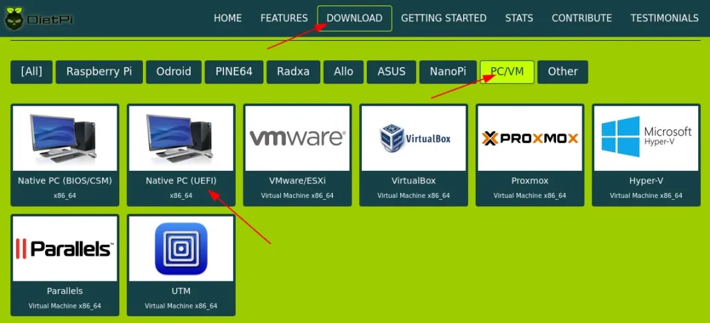

The base installation of DietPi on a PC based system is described in the DietPi docs: See the installation documentation, select the tab “Native PC” and follow the “UEFI installer image” instructions.
The difference to the documentation is that there is no need to change any BIOS settings to boot from the USB disk, USB stick or SD card: Just press the ‘Option’ or ‘Alt’ key during the boot (see there for explanations) and select the medium with the installer image. Then follow the instructions of the installer.
The result should be a system where you also did the first boot procedure (e.g. license acknowledge, basic settings via ‘dietpi-config‘ resp. ‘dietpi-software‘).

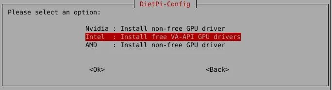

The following additional settings have to be made via dietpi-config:
  • Display options -> Display driver -> Install the ‘Intel GPU driver’

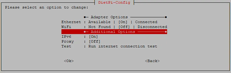

The DietPi basic installation does not contain the WiFi driver package, dietpi-config shows in this case “Not Found”:
dietpi-config output without WiFi driver installed (Ethernet connected)

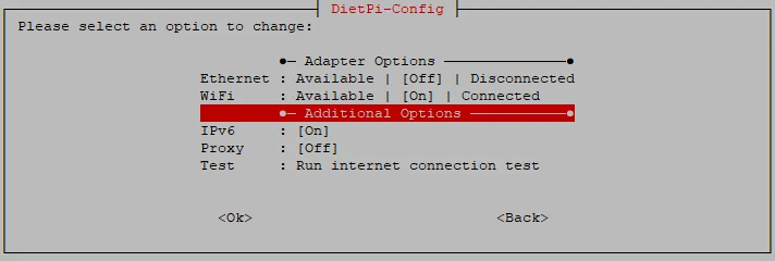

After this steps have been conducted, reboot your system and activate WiFi via dietpi-config in these steps:
  1. Detach the LAN cable
  2. Start dietpi-config
  3. Activate WiFi (do not forget to set the WiFi country code)
  4. Check the WiFi connection
  5. Disable Ethernet in dietpi-config
If this procedure fails, try to disable and enable WiFi again or reboot.
If all went well, dietpi-config should show
dietpi-config output with WiFi connected (Ethernet disabled)
