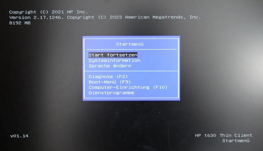

At first, the BIOS settings should be checked/changed to be able to boot from USB devices (no secure boot, USB enable). You can enter the dialog via the <F9> key:
HP T630 Setup dialog

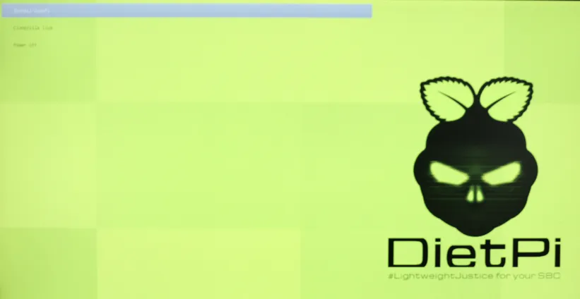

The UEFI installation is based on Clonezilla and starts with the following dialog:
DietPi UEFI installation dialog
At next, you need to walk through the installation process like described in the installation documentation.

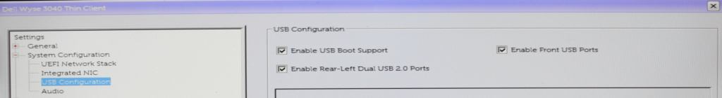

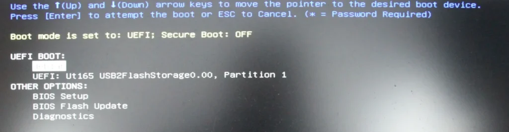

2.2 Wyse 3040

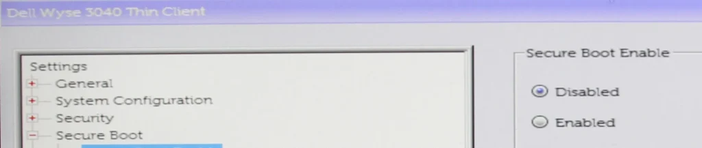

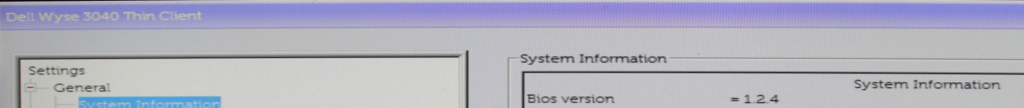

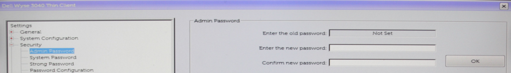

Additionally, you could deactivate a BIOS password (default password: Fireport) and update the BIOS (see Wyse support homepage).
You can enter the setup dialog via the <F12> key:
Wyse 3040 Setup dialog
Wyse 3040 USB enable
Wyse 3040 Secure boot disable
Wyse 3040 Password setting dialog
Wyse 3040 BIOS version

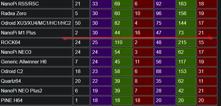

Compared to the benchmark results below, the Wyse 3040 power consumption is similar to the Pi 4 at lower computational power. Often the maximum computational power is not the relevant issue, from this point of view, the Wyse 3040 comes with a nice low power consumption and thermal behaviour.

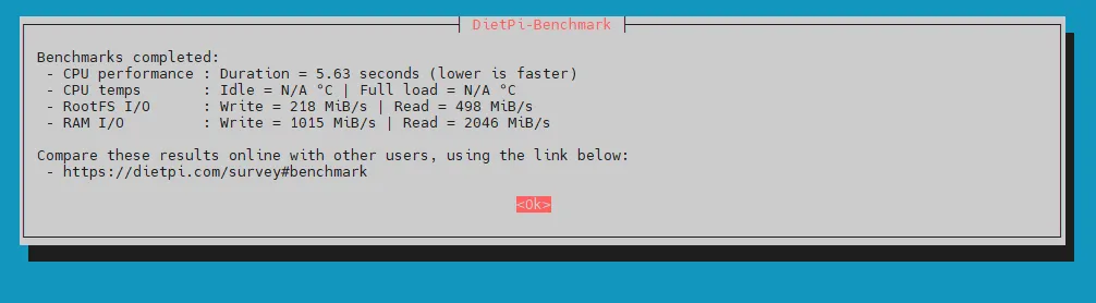

3.3.1 HP T630
The resulting benchmarks show the quite good performance of the HP T630 (with M.2 NVMe):
DietPi benchmark output

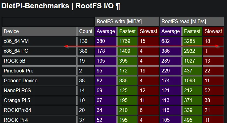

Detail root file system benchmark

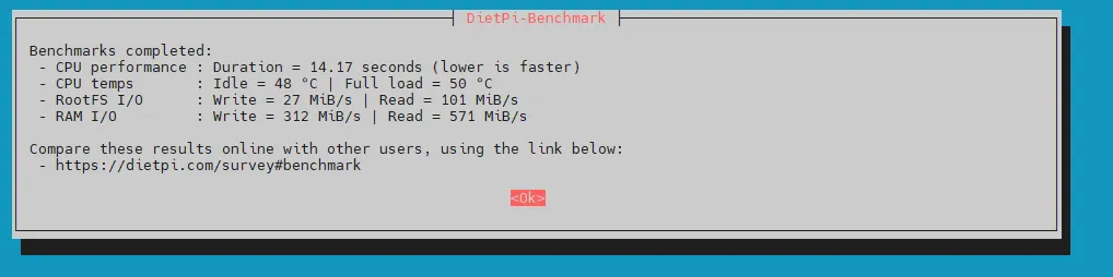

3.3.2 Wyse 3040
The resulting benchmarks show the lower performance of the Wyse 3040:
Detail CPU benchmark
