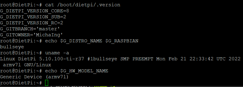

some more information on your device would be helpful
- DietPi version | cat /boot/dietpi/.version
- Distro version | echo $G_DISTRO_NAME $G_RASPBIAN
- Kernel version | uname -a
- SBC model | echo $G_HW_MODEL_NAME or (EG: RPi3)
the kernel module is available?
dpkg-query -S '/lib/modules/*/wireguard.ko'
modinfo wireguard | grep 'filename:'
Btw: no need to do screen prints. You could simply copy the output directly SSH terminal and past it into your replay.
