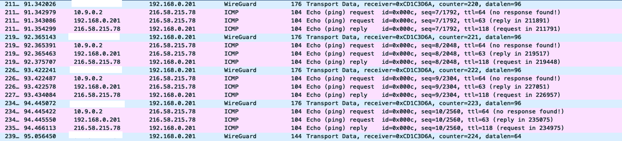

I have freshly reflashed my old buster WIreguard VPN server to bullseye and Wireguard is not working anymore. It worked well on buster though. I did some digging using tcpdump on the board and found the traffic from the wireguard client - my phone is actually forwarded to eth0 and out, but when the response gets back from the internet to eth0, it’s not forwarded back to wg0. This is kinda strange as all iptables rules are the same on my bullseye. So I can’t figure out what’s the problem here. Maybe you did encounter the same issue?

# iptables -L -v
Chain INPUT (policy ACCEPT 0 packets, 0 bytes)
pkts bytes target prot opt in out source destination
Chain FORWARD (policy ACCEPT 0 packets, 0 bytes)
149 8940 ACCEPT all -- wg0 any anywhere anywhere
Chain OUTPUT (policy ACCEPT 0 packets, 0 bytes)
# iptables -L -v -t nat
Chain PREROUTING (policy ACCEPT 0 packets, 0 bytes)
Chain POSTROUTING (policy ACCEPT 0 packets, 0 bytes)
66 4141 MASQUERADE all -- any eth0 anywhere anywhere
# sysctl -a | grep forward
net.ipv4.conf.all.forwarding = 0
net.ipv4.conf.all.mc_forwarding = 0
net.ipv4.conf.default.forwarding = 0
net.ipv4.conf.default.mc_forwarding = 0
net.ipv4.conf.eth0.forwarding = 1
net.ipv4.conf.eth0.mc_forwarding = 0
net.ipv4.conf.lo.forwarding = 0
net.ipv4.conf.lo.mc_forwarding = 0
net.ipv4.conf.wg0.forwarding = 1
net.ipv4.conf.wg0.mc_forwarding = 0
net.ipv4.ip_forward = 0
net.ipv4.ip_forward_use_pmtu = 0
net.ipv6.conf.all.forwarding = 0
net.ipv6.conf.all.mc_forwarding = 0
net.ipv6.conf.default.forwarding = 0
net.ipv6.conf.default.mc_forwarding = 0
net.ipv6.conf.eth0.forwarding = 1
net.ipv6.conf.eth0.mc_forwarding = 0
net.ipv6.conf.lo.forwarding = 0
net.ipv6.conf.lo.mc_forwarding = 0
net.ipv6.conf.wg0.forwarding = 1
net.ipv6.conf.wg0.mc_forwarding = 0
