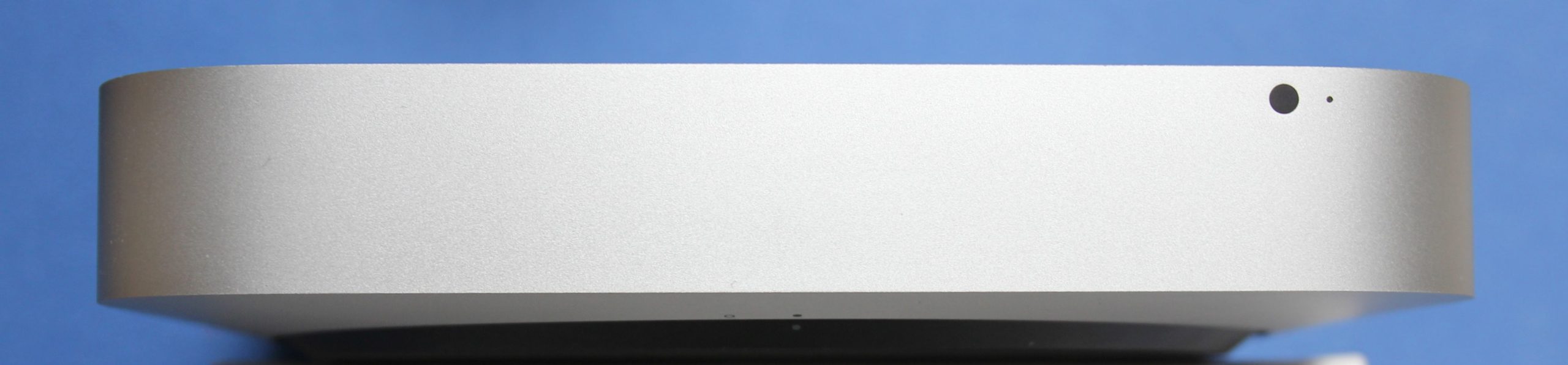

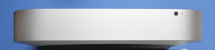

I am using such a PC also (in my case an Apple Mac mini).
Works very well.
