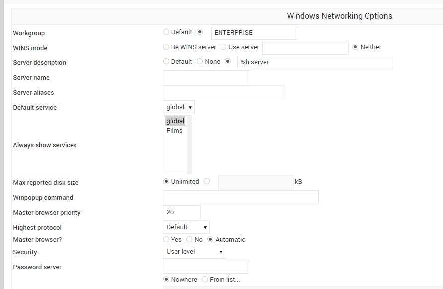

I quickly installed Webmin on a Demo VM and was able to create a new share, which I could access from my Win10 machine.
Did you checked the SAMBA User section on Webmin? Pls have a look to Samba User and check if perco is listed there. If not, return to previous page and go to Convert Users. There you should check first option Only listed users or UID ranges. Select your user perco and set a password. This is needed because Samba users are different from OS user. Once converted, you should be able to access the share. At least that’s how it was working for me.

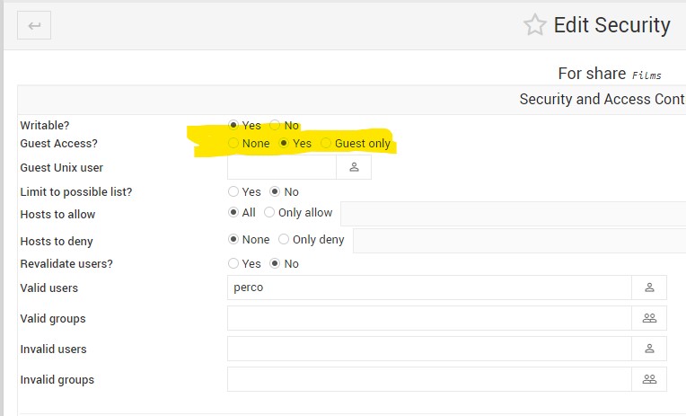

For it’s working. I can create new directories. Did you checked if the share is set writable ? For me it looks like the attached

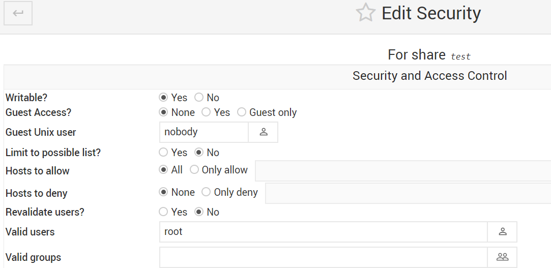

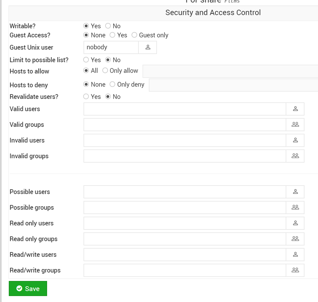

Maybe you can try to create new share and guest access to NO?
started from scratch…

I now have a better result with guest access on yes.

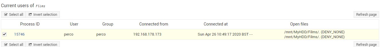

Finaly…
what one should not forget when testing is that you have to clear the windows user accounts credentials and restart the samba server with every change.
