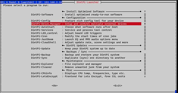

Drive Manager shows the following. I try to open it the first time and nothing happens so I have to cancel. Then I try again and I get the following “concurrent execution” message.
this is the launcher and not drive manager shown on the picture.
this is logic and expected as you cancel the first session leaving some parts behind. How long do you wait before cancelling the session? For me it looks like you have an external mount point that is not reachable, leading drive manager to hang. Usually there should be a timeout after 90 sec. Can you share your /etc/fstab file.

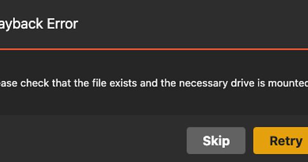

Well, we are getting somewhere. I checked the USB drive and oddly enough, it was powered off. My mistake! Now I can access the drive again. However, when I try to access my Plex media it still says that the media is unavailable. Linked below are screenshots within Plex:
I have tried power cycling everything but to no avail. I also believe that 192.168.127 is actually correct, as this is the “local IP” for the Raspberry Pi.
