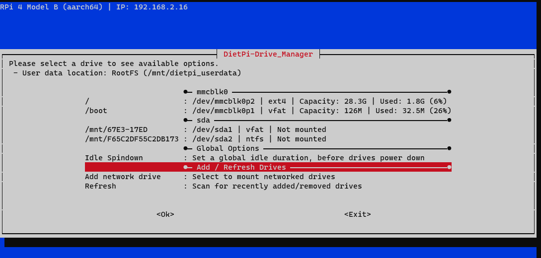

After this text slowly shows, maybe one line every minute, another few more lines of text show up very quickly and it loads the blue background screen for “DietPi-Drive_Manager”
Hmmm so I’m not sure what happened but it doesn’t appear to be showing the 8TB drive anymore at all, whatsoever. Double checked and yes the drive is plugged in via USB, and powered on.
The drive (/mnt/F65....) is not mounted. Mark the right entry, hit enter and mount it.

probably due to the back and force of using drive manager the entry got lost. Simly select the device /dev/sda2 and mount it again to /mnt/8tb
