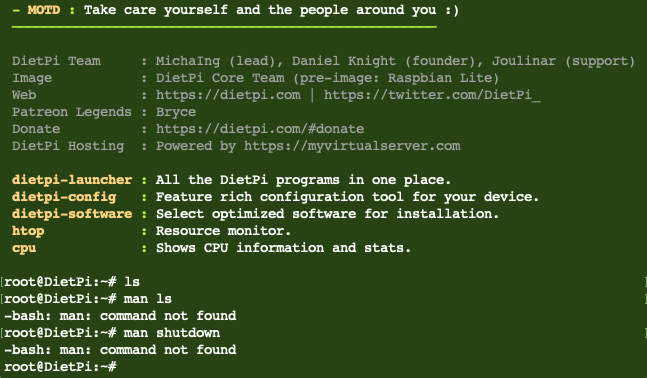

My difficulty is not accessing the Pi through SSH but accessing standard Linux Commands - for example ‘Shutdown’.
Please see attached screenshot as an example.
I look forward to further advice.
You are trying to use the man command which is not available on a fresh DietPi images. If you want to check, if a command is available, you could do:

If you really need to see the man pages on console, install the related package. Generally to find packages required to gain a certain command, the online man page site helps with this as well: https://manpages.debian.org/man
Note at the top: / buster / man-db / man(1)
Means the man command on Buster is available via man-db package. Hence do:
apt install man-db
man ls
yep indeed. Using man will bring the use manual. To have the command executed, just use the command without man in front.
