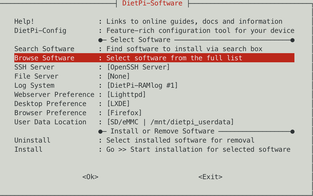

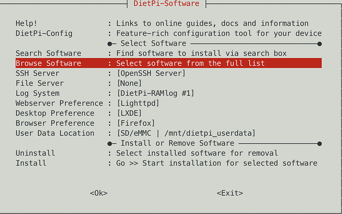

can you have a look if it is installed via dietpi-software?
Joulinar
apparently i installed firefox once because it shows up. However, the first installation was a long time ago and I actually only use WireGuard and piHole.
Sorry ![]()
I looked directly under the available software, there is no x for Firefox.
ok it is not installed via dietpi-software. Let’s remove it if not required.
