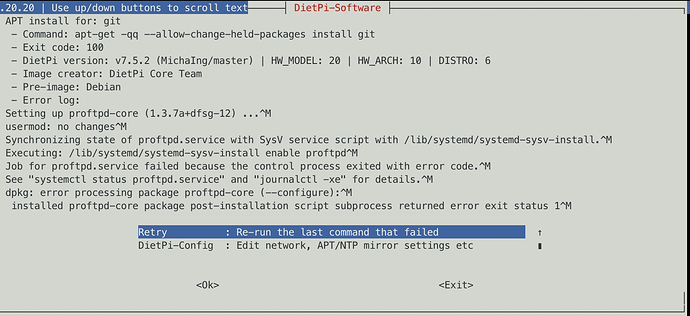

Up to dietpi-software reinstall 93 everything went through without any problems, but now there is an error, see screenshot.
You have ProFTP installed?
Joulinar
yes, this is shown under dietpi software. :open_mouth:

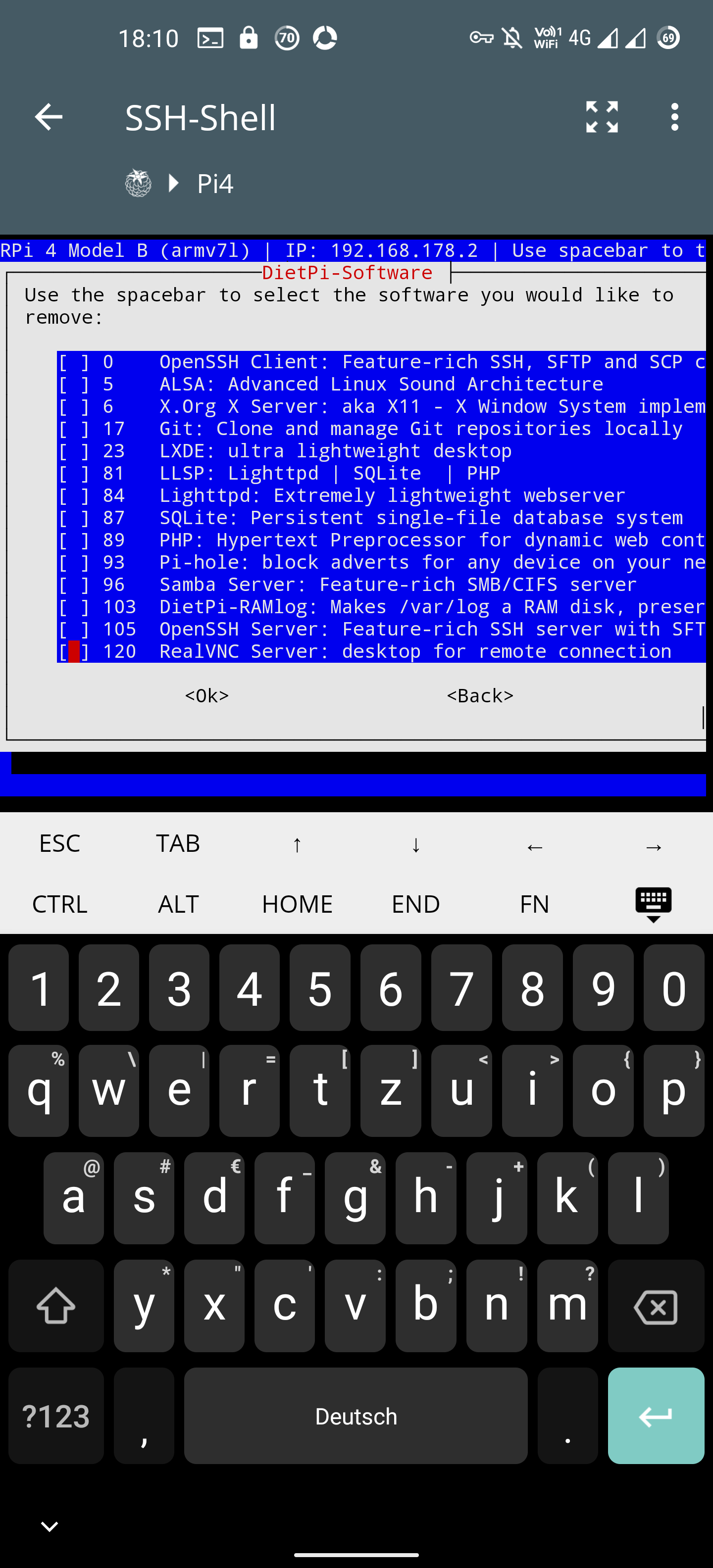

If not needed you could remove it. Otherwise we would need to fix it.
Joulinar
I uninstalled it and now it worked, PiHole is running again including interface. Thank you for your support, without your help I would not have made it. :slight_smile:
