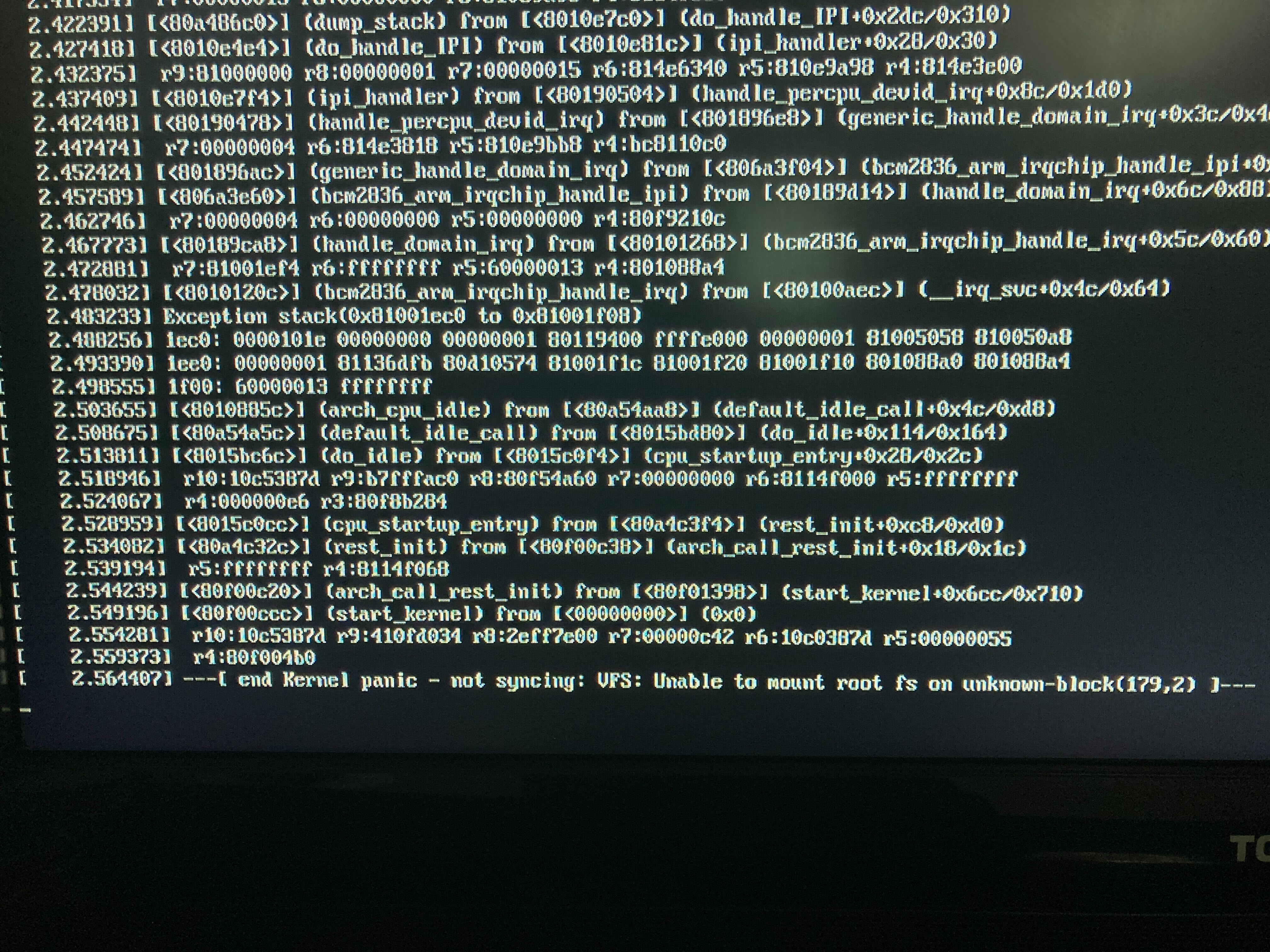

I tried the first link before you posted that, it booted but then I got an error about a kernel panic
not syncing VFS: unable to mount root fs on unknown-block(179,2)

Thanks, I’ve just done that but I get this message when I try to start now:
Yeah there is some file system corruption I guess. Probably we could try to fix if you plug the SD into another Linux box and run some file system scan.
