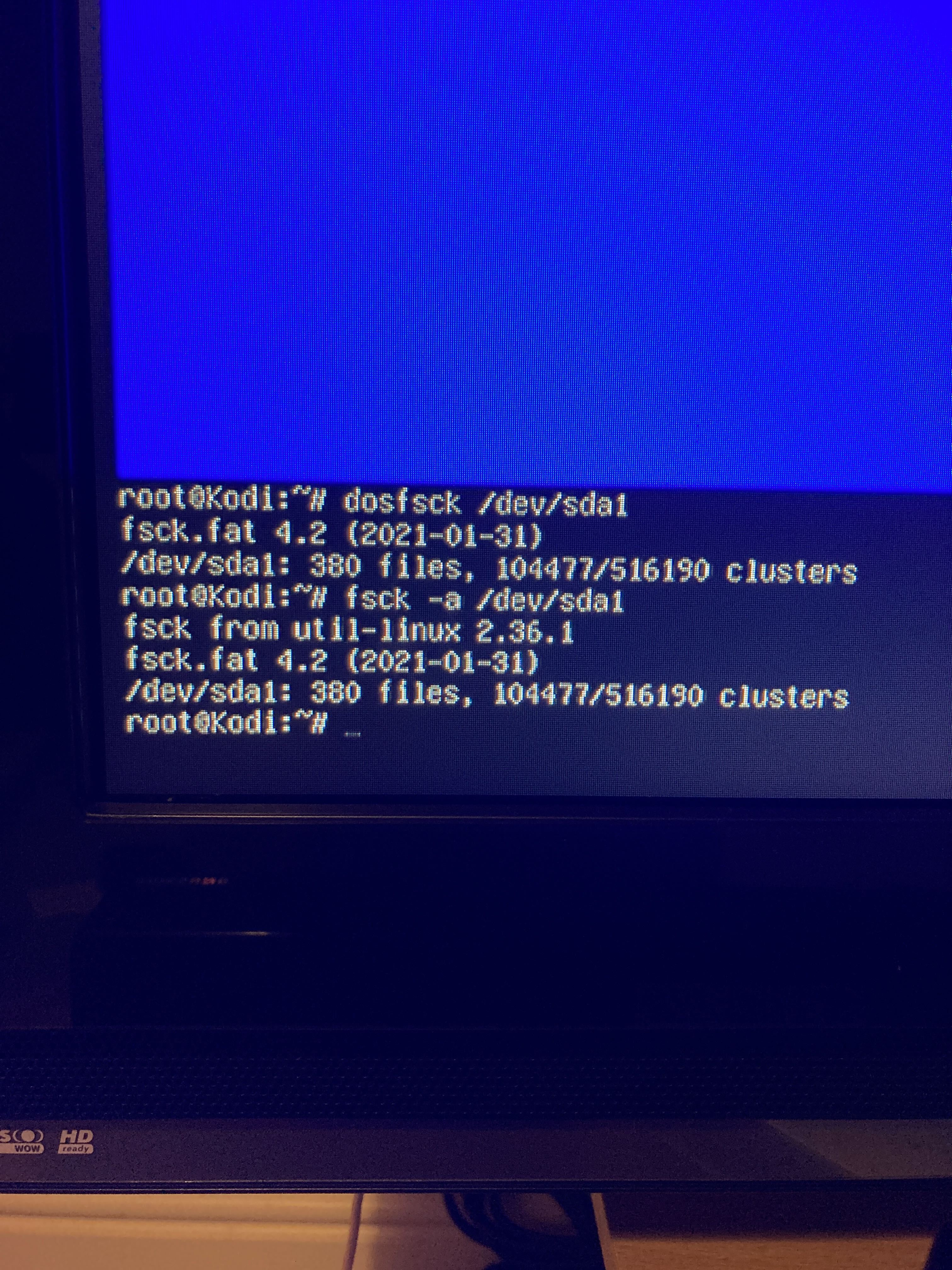

Thanks I’ve tried that both commands finished right away but I still get the same :frowning:
This is what I saw when I tried those two commands:
you did not checked sda2, did you?
fsck -a /dev/sda2

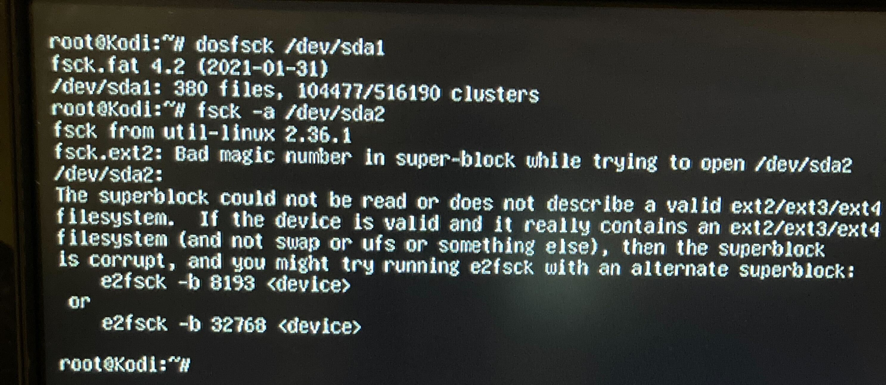

This is what I get from
fsck -a /dev/sda2
could you try one of the two commands at the end.

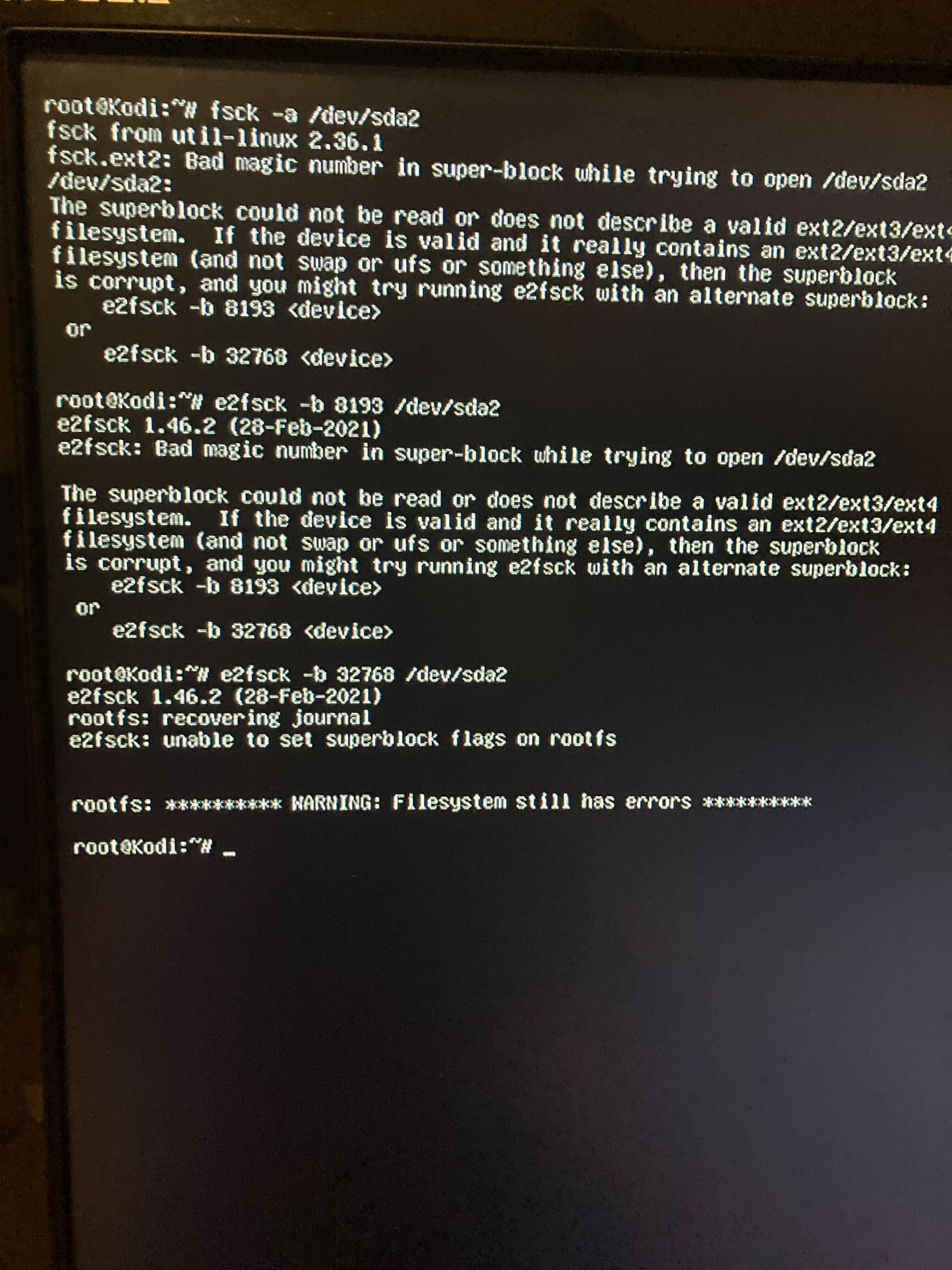

e2fsck -b 8193 /dev/sda2
BTW: you are not using SSH to connect to your DietPi device? Looks like a screen :slight_smile:
Yeah I’m using a screen I have my other Pi connected to.
I tried the 1st one and then the second:

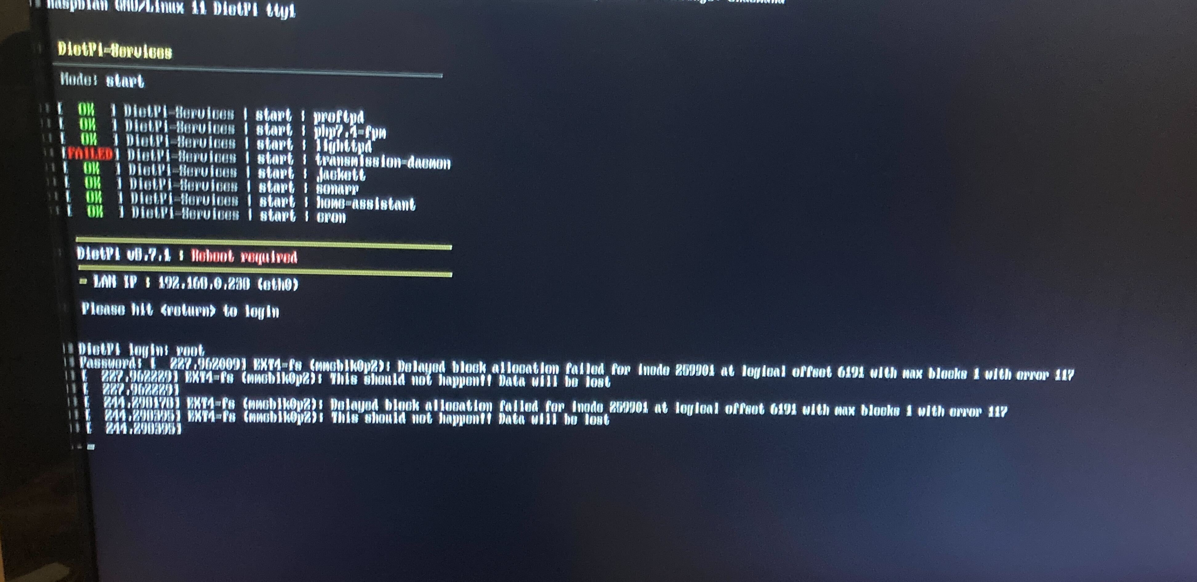

I put the SD back in my PI and it booted but I randomly got this message on the screen:
I did a reboot I got the same again, I’ve just rebooted again now I’m back to the “unknown-block(179.2)” message :frowning:

I put the sd back in my other pi and tried fsck again, now for
fsck -a /dev/sda2
it doesn’t finish right away it does a bunch of checks and asks me to confirm y for things like
i_size is 281474976714754 , should be 0
or Inode 274695 has illegal block(s) clear?
Should I do it?
let’s wait for @MichaIng to give some advice.
In general, the SD card doesn’t looks very healthy :frowning:

you have some file system corruption on your SD card. I’m not sure if simply copying the files will work.
I’ve run fsck a few times and don’t seem to have any issues with booting any more but I want to switch to another SD just to be sure. I’ve done dietpi-backup will that back up my home assistant, sonarr and jackett settings?
