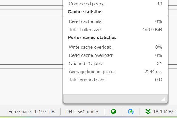

I m also having problems with torrent speed also Raspberry Pi 4

Now speed are up to 50 MBits stable but only when downloading 2 torrents at once to HDD more downloading torrents drops downloading speeds.
