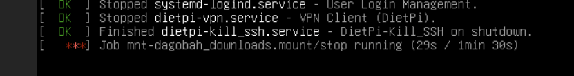

  1. Issue “poweroff” commend within VM. Or issue Shutdown to VM command from Proxmox.
  2. Witness the error: [FAILED] Failed unmounting mnt-mysambashare.mount - /mnt/mysambashare.
    (actual name of share changed for this post).
  • VM shuts down, or reboots, without issue.
  • error: [FAILED] Failed unmounting mnt-mysambashare.mount - /mnt/mynetworkshare. appears in console and VM hangs until forcefully reset.
  • If I run the below command the VM will shutdown fine. But this forces the unmount and has to be carried out via the console - I cannot issue the command as part of the shutdown process from Proxmox.
  • umount -f -l /mnt/mysambashare && poweroff

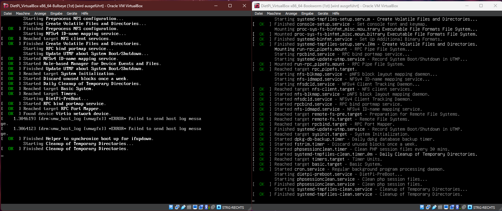

I tested it as well on some VMs here, and neither CIFS/SMB nor NFS mounts have Before=remote-fs.target. And indeed this means that any service sorting itself After=remote-fs.target is not assured to stop before network mounts are tried to be unmounted. Here logs from a Bullseye and Bookworm VM, which both show this pretty clearly:
root@VM-Bullseye:~# journalctl -u qbittorrent -u mnt-samba.mount -u mnt-nfs_client.mount -u remote-fs.target -u remote-fs-pre.target
Jun 29 16:22:48 VM-Bullseye systemd[1]: Unmounting /mnt/nfs_client...
Jun 29 16:22:48 VM-Bullseye systemd[1]: Unmounting /mnt/samba...
Jun 29 16:22:48 VM-Bullseye qbittorrent-nox[2785]: Catching signal: SIGTERM
Jun 29 16:22:48 VM-Bullseye qbittorrent-nox[2785]: Exiting cleanly
Jun 29 16:22:48 VM-Bullseye systemd[1]: Stopping qBittorrent (DietPi)...
Jun 29 16:22:48 VM-Bullseye systemd[1]: mnt-samba.mount: Succeeded.
Jun 29 16:22:48 VM-Bullseye systemd[1]: Unmounted /mnt/samba.
Jun 29 16:22:48 VM-Bullseye qbittorrent-nox[2785]: ******** Information ********
Jun 29 16:22:48 VM-Bullseye qbittorrent-nox[2785]: To control qBittorrent, access the Web UI at http://localhost:1340
Jun 29 16:22:48 VM-Bullseye systemd[1]: qbittorrent.service: Succeeded.
Jun 29 16:22:48 VM-Bullseye systemd[1]: Stopped qBittorrent (DietPi).
Jun 29 16:22:48 VM-Bullseye systemd[1]: Stopped target Remote File Systems.
Jun 29 16:22:54 VM-Bullseye systemd[1]: mnt-nfs_client.mount: Succeeded.
Jun 29 16:22:54 VM-Bullseye systemd[1]: Unmounted /mnt/nfs_client.
Jun 29 16:22:54 VM-Bullseye systemd[1]: Stopped target Remote File Systems (Pre).
root@VM-Bookworm:~# journalctl -u qbittorrent -u mnt-samba.mount -u mnt-nfs_client.mount -u remote-fs.target -u remote-fs-pre.target
Jun 29 16:22:46 VM-Bookworm systemd[1]: Unmounting mnt-nfs_client.mount - /mnt/nfs_client...
Jun 29 16:22:46 VM-Bookworm systemd[1]: Unmounting mnt-samba.mount - /mnt/samba...
Jun 29 16:22:46 VM-Bookworm systemd[1]: Stopping qbittorrent.service - qBittorrent (DietPi)...
Jun 29 16:22:46 VM-Bookworm qbittorrent-nox[2272]: Catching signal: SIGTERM
Jun 29 16:22:46 VM-Bookworm qbittorrent-nox[2272]: Exiting cleanly
Jun 29 16:22:46 VM-Bookworm qbittorrent-nox[2272]: WebUI will be started shortly after internal preparations. Please wait...
Jun 29 16:22:46 VM-Bookworm qbittorrent-nox[2272]: ******** Information ********
Jun 29 16:22:46 VM-Bookworm qbittorrent-nox[2272]: To control qBittorrent, access the WebUI at: http://localhost:1340
Jun 29 16:22:46 VM-Bookworm systemd[1]: mnt-nfs_client.mount: Deactivated successfully.
Jun 29 16:22:46 VM-Bookworm systemd[1]: Unmounted mnt-nfs_client.mount - /mnt/nfs_client.
Jun 29 16:22:46 VM-Bookworm systemd[1]: qbittorrent.service: Deactivated successfully.
Jun 29 16:22:46 VM-Bookworm systemd[1]: Stopped qbittorrent.service - qBittorrent (DietPi).
Jun 29 16:22:46 VM-Bookworm systemd[1]: mnt-samba.mount: Deactivated successfully.
Jun 29 16:22:46 VM-Bookworm systemd[1]: Unmounted mnt-samba.mount - /mnt/samba.
Jun 29 16:22:46 VM-Bookworm systemd[1]: Stopped target remote-fs.target - Remote File Systems.
