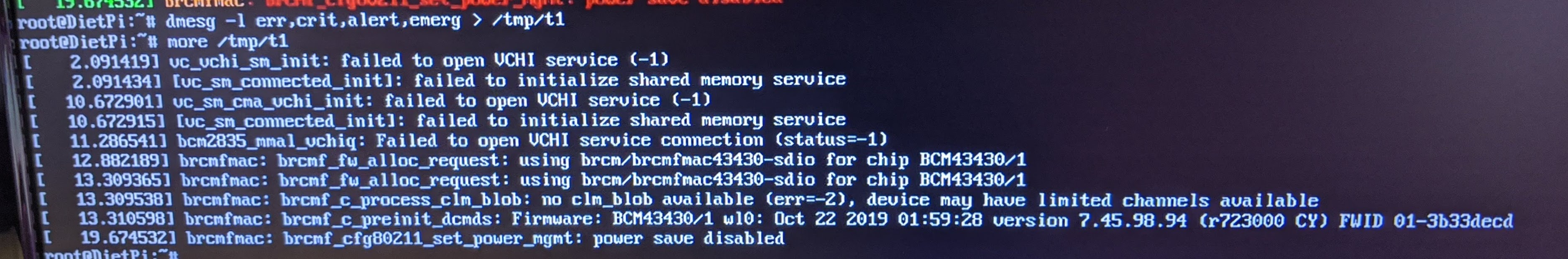

Did you tried with a different SD card? Do you use WiFi or Ethernet? Can you check for kernel messages dmesg -l err,crit,alert,emerg
Thanks for reply,
Right after the creation of the SD card (second time), SSH worked ok, but after around 1 day, stopped working
The Pi zero W is connected to Wifi
Here’s the output of dmesg

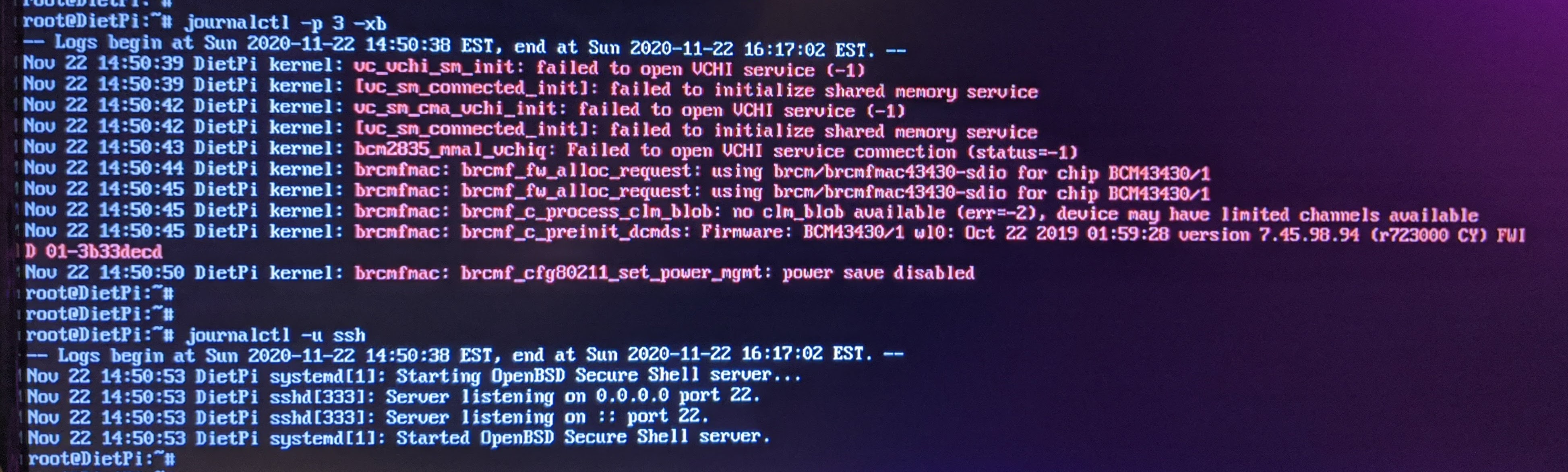

Here’s the output of journalctl
I installed DietPi in a Hyper-V VM… no issue with SSH and Time sync. A bit faster on my i7-32gig than a Pi zero!
Fun debug here!
well this is the output for ssh for which you open the other topic :wink:
