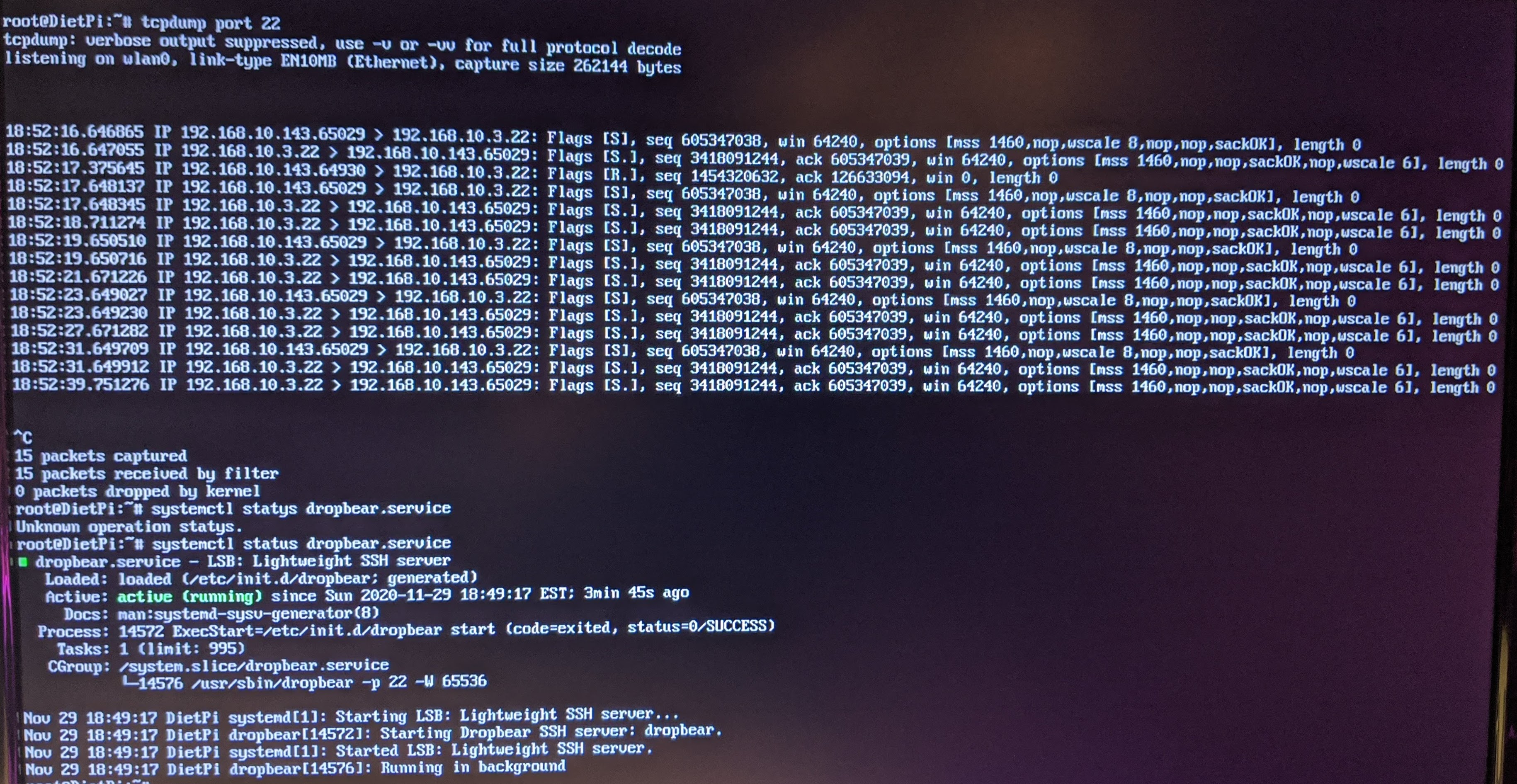

Here’s the output of my console after a restart of dropbear
You can see tcpdump is showing traffic on port 22 to my PC: 192.168.10.143. And the status is ok.

In the third line of the tcpdump the putty client is sending a reset packet, although it should be sending an ack.
In the next lines the dropbear is sending synack to putty, but putty seems to be ignoring them and keeps resending syn.
It looks to me that putty is not receiving the packets from dropbear, hence the high send-q number.

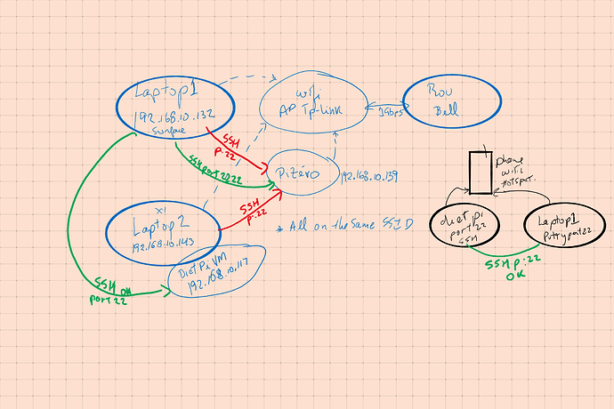

Just tried a separate Wi-Fi created with my phone. A laptop to PiZero on this “private” network, Putty port 22 works fine.
Reactivated the wifi on the Bell router, connected a laptop and the PiZ, ssh works.
So seems to be the AP TP-LIKN EAP245 with an issue
I’m wondering if being on the same SSID and the laptop connected with 5G and the Pi with 2.4G would be an issue?

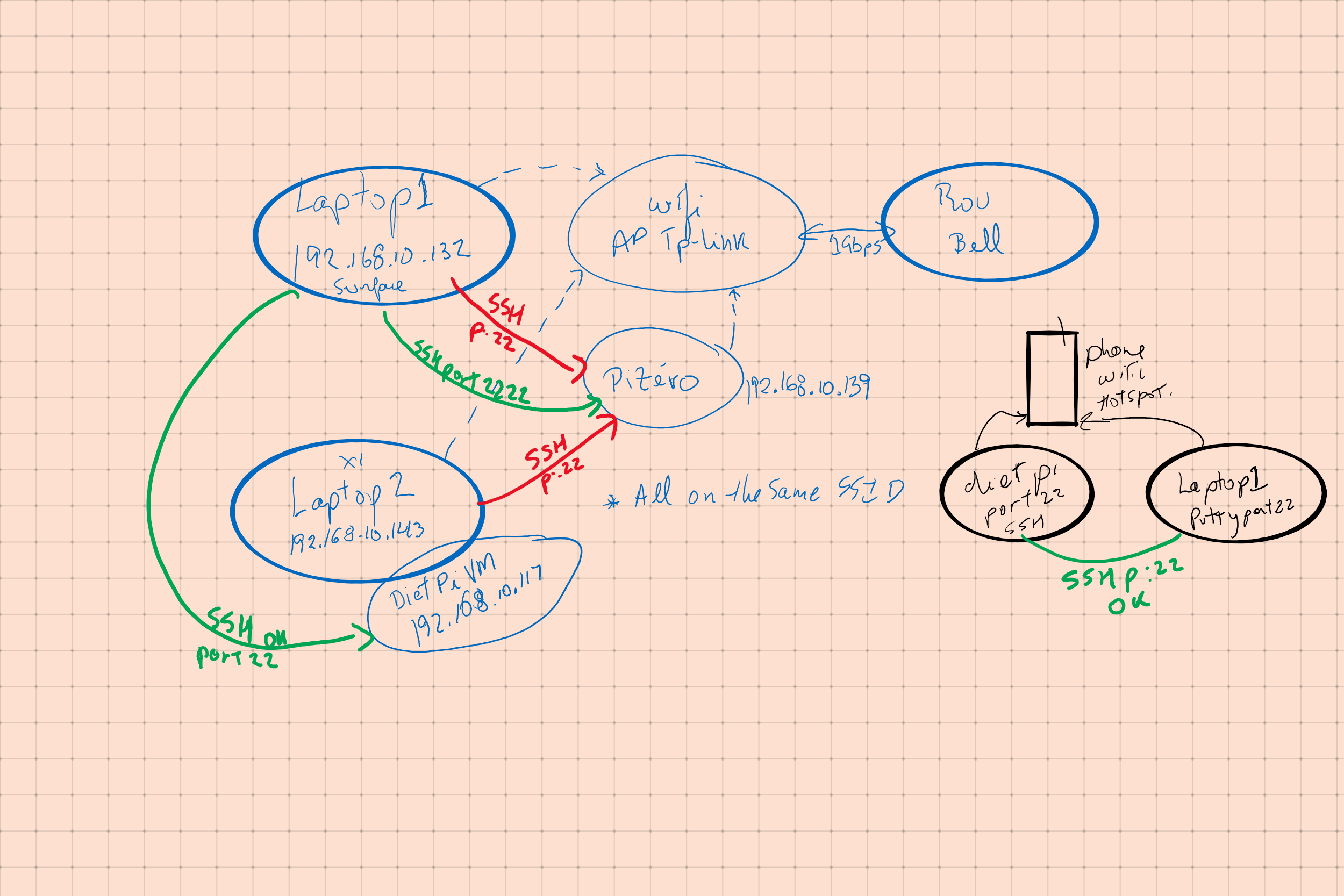

Here’s a rough drawing of my setup. Redlines are ssh not working, green are ssh working.
Thanks

Tested on a 2.4G only SSID. Connected both PiZero and laptop, same issue. So it’s not an issue of 2.4G vs 5G
Then I tested another laptop connected with a wired connection to connect to the PiZero on a 2.4G wifi. So not going through wifi on the Putty side did not change that Putty cannot connect.
So…
Laptop (EAP245 wifi 5G) > PiZero (EAP245 2.4G) SSH on port 22 = Not working
Laptop (EAP245 wifi 5G) > PiZero (EAP245 2.4G) SSH on port 2222 = working
Laptop (EAP245 wifi 2.G) > PiZero (EAP245 2.4G) SSH on port 22 = Not working
Laptop (wired) > PiZero (EAP245 2.4G) SSH on port 22 = Not working
Laptop (Phone Wifi) > PiZero (Phone Wifi ) SSH on port 22 = working
Laptop (Bell-router Wifi) > PiZero (Bell router) SSH on port 22 = working
So, the issue is around port 22 over my EAP245 Wifi.
