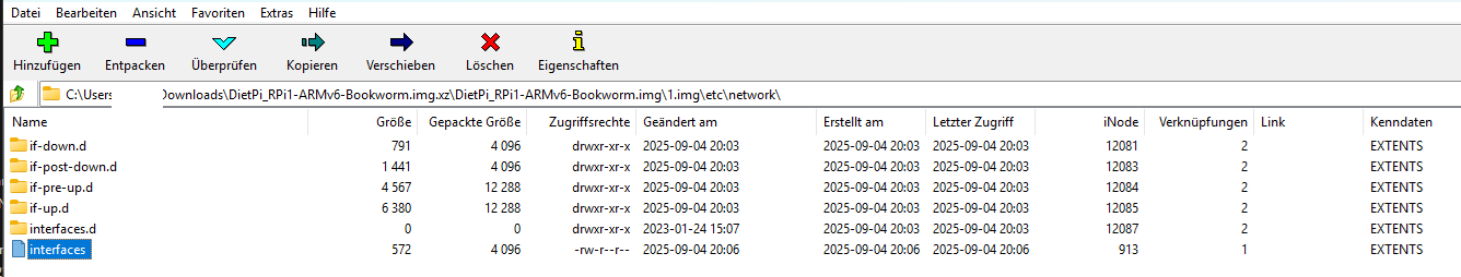

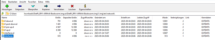

No, that’s part of the image and should be there. You can check for yourself by opening the archive and image.
We only modify the file based on the settings you set in dietpi.txt. Are you sure you looked in the right place?
