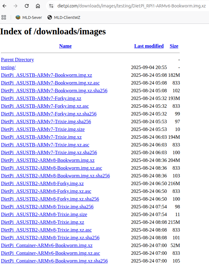

Yes, and if i click the img.xz, I see this:
ok so we might need look into the web server hosting our download files.
@Melomane Can you check that again? The images are already available in the regular download folder.
The view you saw was a hanging Cloudflare cache. This has now been cleared.
Thanks, I had to empty the Browsercache and got the Download! :slight_smile:
This is what I meant with this, means the links from the download page point to the new images already, but I forgot to purge the directory index documents from the Cloudflare cache, hence they were showing wrong content and timestamps.

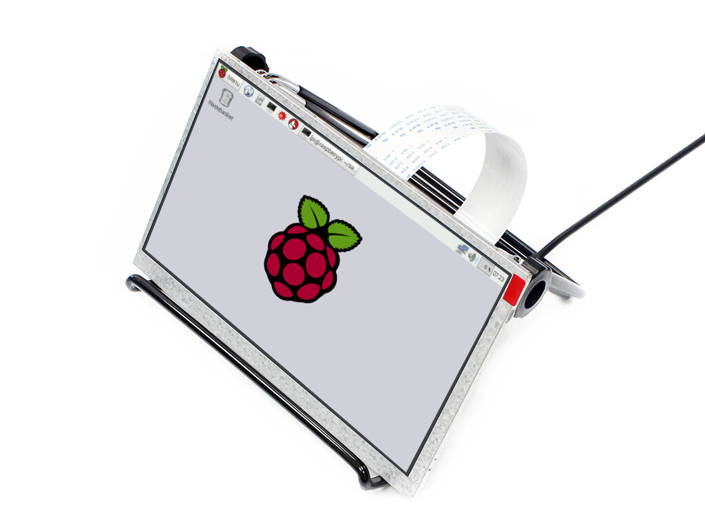

Yes, I think so too. Well, I have an HDMI-Display, this one:
No problem with an Pi Zero WH. But so far, it doesn’t want to work with the Pi1. For the newer Zero, I had to configure the following in Config.txt:
#dtoverlay=vc4-kms-v3d
dtoverlay=dpi24
enable_dpi_lcd=1
display_default_lcd=1
dpi_group=2
dpi_mode=87
dpi_output_format=0x6f005
hdmi_cvt 1024 600 60 6 0 0 0
disable_overscan=1
But with this configuration, the Pi1 won’t start even with Raspbian.
Do you know how I need to configure the display?
AFAIK with the new kernel stack, KMS is required and the dedicated KMS overlay for this display. Several legacy components have been removed.
KMS + display_auto_detect=1 should work.
EDIT: The product page you linked even describes it. Aside of base KMS overlay, try with auto-detect above, which might select the needed overlays (aside of KMS) automatically, based on what it detects.
