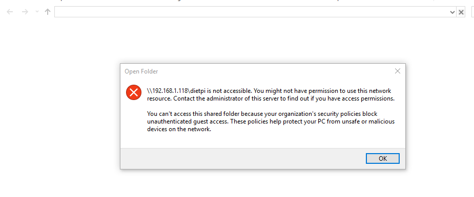

in win10, i still cannot view the shared folder (same issues as in the photos in first page).

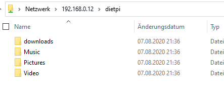

I guess you would need to enter the full path into W10 Explorer
\<>\dietpi
At least, that’s how it is working for me
I use the full path “\192.168.1.118\dietpi” but the access is denied.
maybe windows cannot identify some special characters (i had this issue 2 months ago, when i was trying smb share through dietpi).
