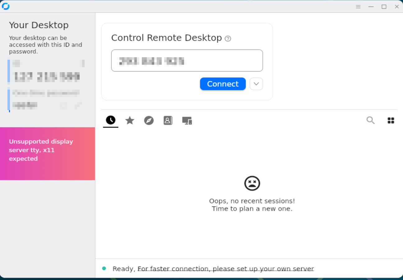

The plan is to use Rustdesk on the raspberry pi device for local network access. I keep getting an “Unsupported display server tty, x11 expected” on the Rustdesk screen. I have poked around, but no joy. Can someone point me in the right direction??

you mean this?

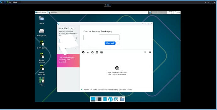

I could connect to the machine just fine, despite this error message:
But XDG_SESSION_TYPE is set to tty despite the fact that XFCE is running, maybe this is why we see the message but it’s working anyways.
I guess it#s still tty because we start it from console via startx. And Rustdesk works because there is a display available.
@MichaIng what do you think?
edit #2:
When setting autostart to Desktop → LightDM login mask, XDG_SESSION_TYPE is set to x11 tho and the message does not appear.
