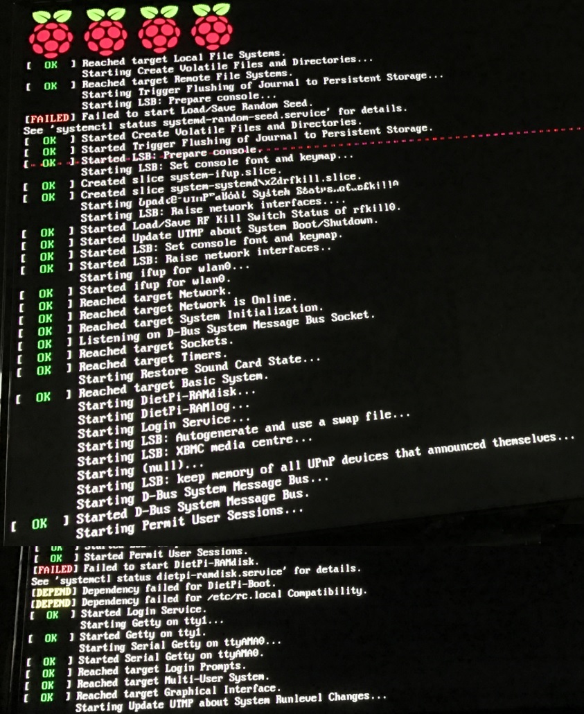

But when I power on, RPI generates the error showed in attached immagine2.jpg

I accurately followed the steps that you’ve shown me, so the error is when I powered on the system without USB drive (psyhically removed from system).

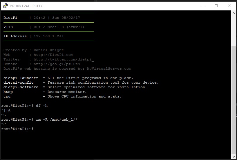

Any way, despite the error, I tried to run
rm -R /mnt/usb_1/*
in a putty window but RPI remains as if it were frozen (I have to use Ctrl C to have the cursor back again) see immagine3.jpg
After this, when I reboot the system always without USB drive plugged in, I always have the error showed to you in immagine2.jpg

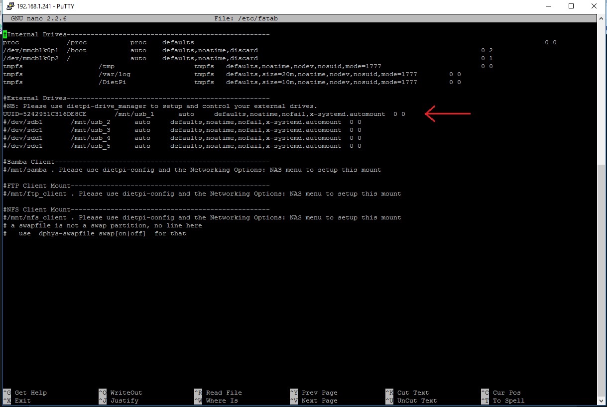

I commented the line showed by red arrow.
But the issue came when I tried to save, because of a message indicating not enough space on device.
I closed it and when I opened fstab again, I found it empty, no lines inside. :open_mouth:
I tried to rewrite the line, coping them from the attached file, but it was impossible to save because of not enough space again.

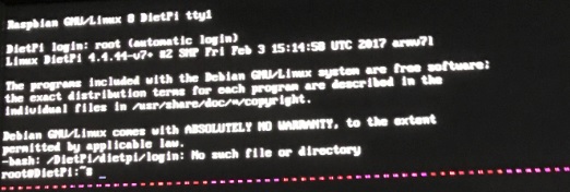

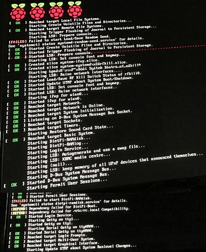

I rebooted hoping to free space on device but it was worse because now booting errors increased, there is a login error (see immagine5 and immagine6) and I have no write permission (despite I use ‘sudo nano /etc/ftab’). Furthermore, putty does not work anymore.
