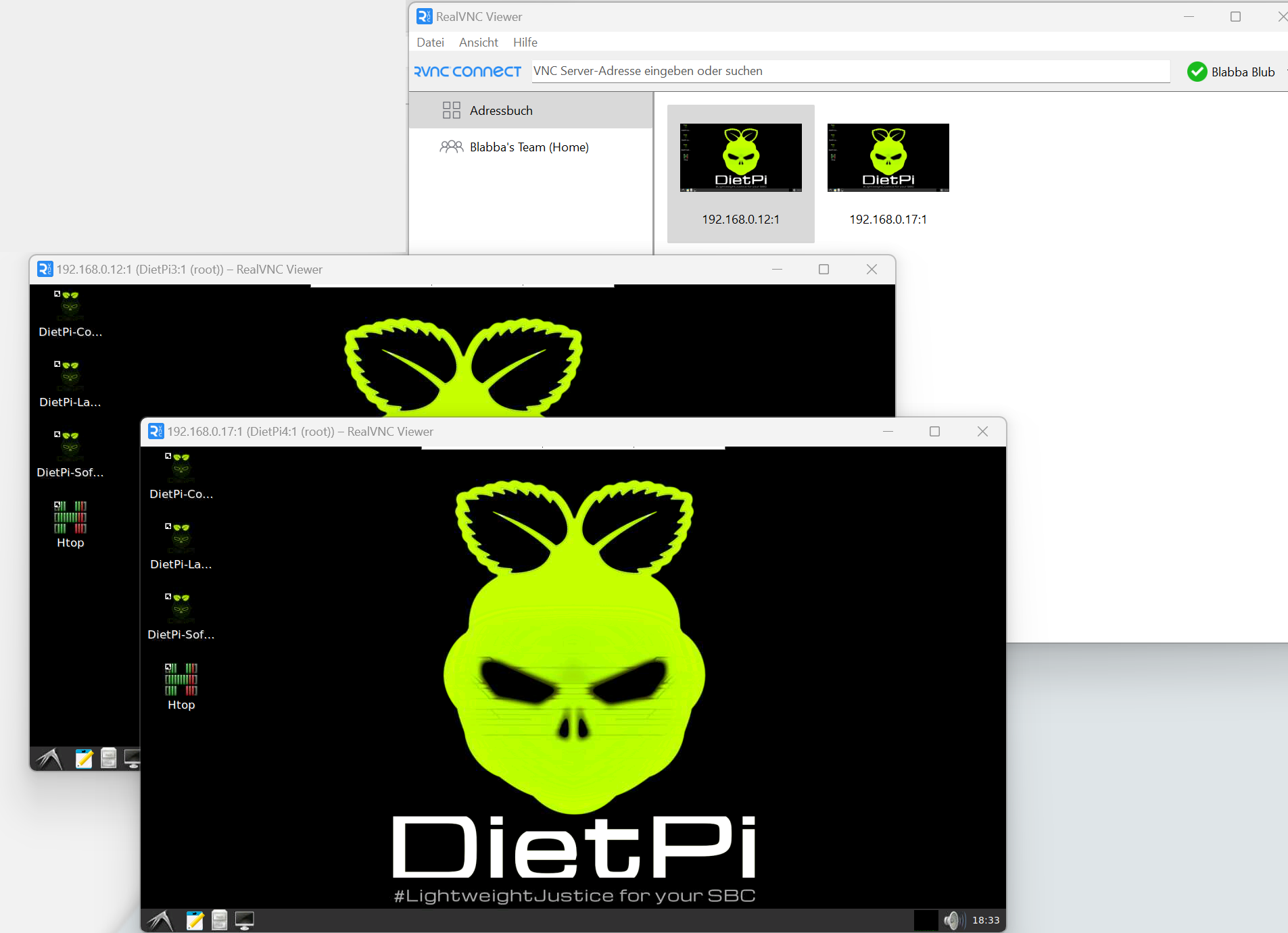

Did a test again on 2 different RPi
  • RPi3B+ 32bit
  • RPi4B 64bit
Both running latest version of DietPi v8.19.1
To install RealVNC
dietpi-software install 120

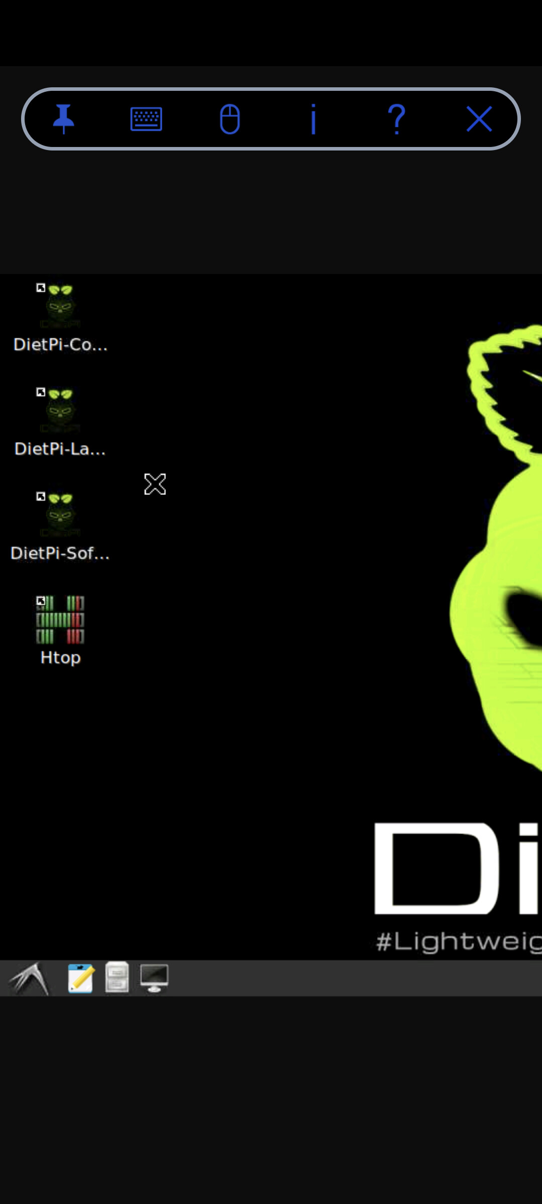

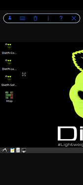

I selected LXDE without a browser. Once completed I rebooted my systems and was able to connect from Windows as well as Android App.
I simply created a new client connected, specified IP address like 192.168.0.17:1, hit connect, accepted the new fingerprint und entered root user password. Done. Nothing more to-do.
