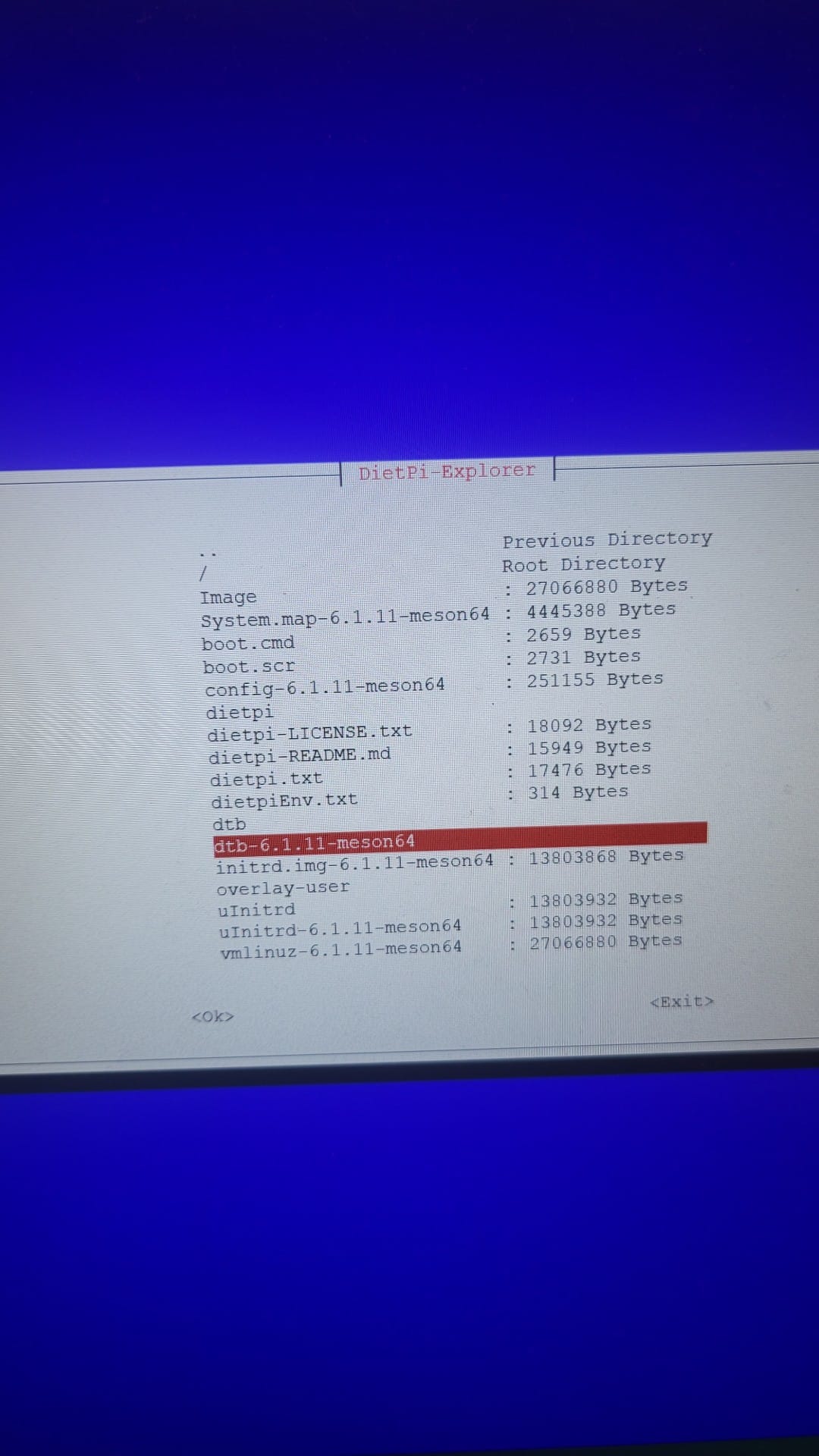

Under boot directory i do not have config.txt file
Dietpi installed on emmc i’m using PuTTY on windows and kyboard with TV after flashing emmc or micro sd with system i cannot browse the files.

config.txt is RPi specific file and not available on other SBC.

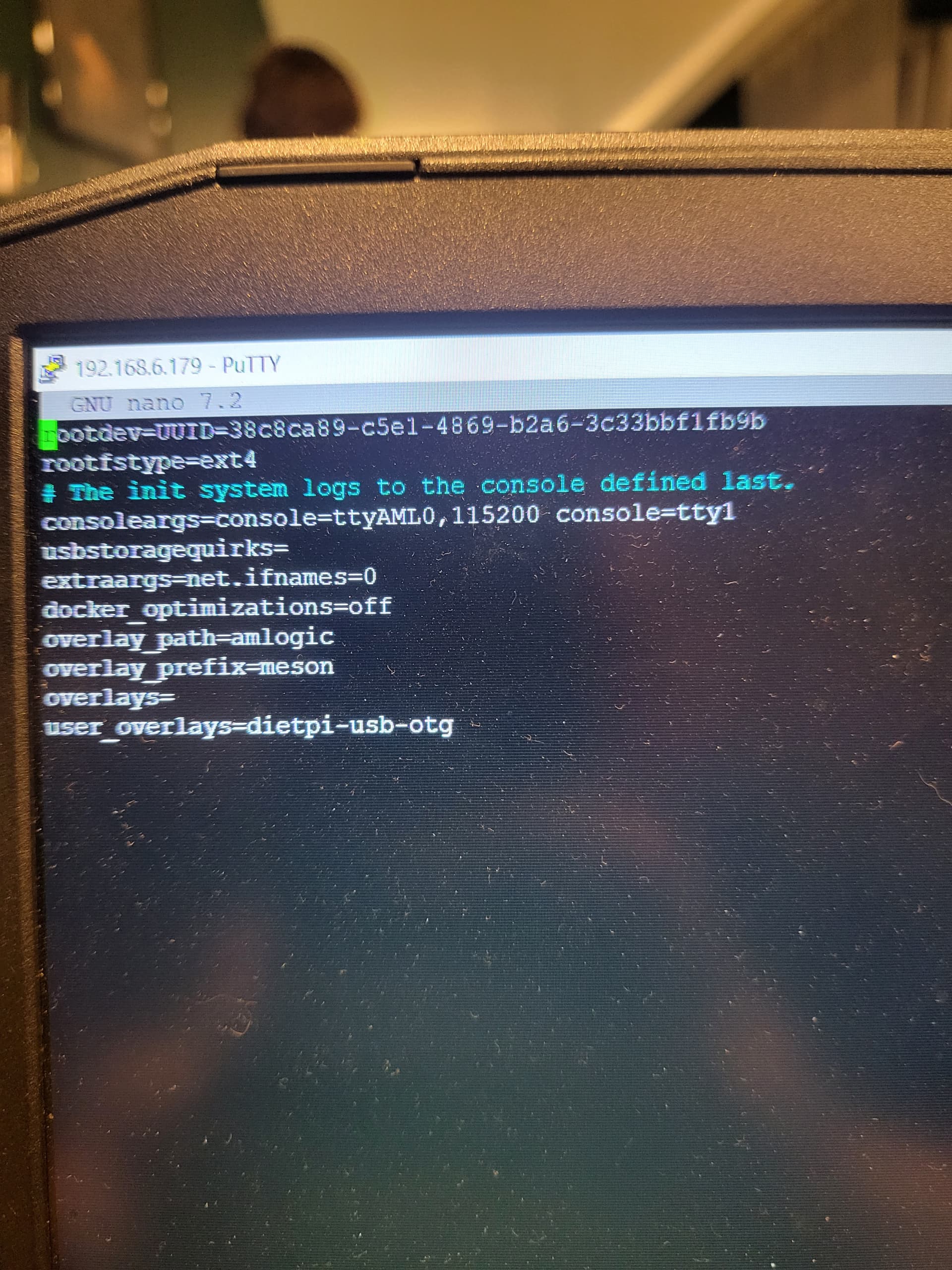

YOo need add the correct overlay in /boot/armbian.txt I think.
or is it dietpiEnv.txt? there should be another txt file :smiley:
Maybe @MichaIng knows which one is needed
There is dietpiEnv.txt and look like this:

Other than GPIO-attached LCDs, HDMI LCDs do not require any device tree overlay.
What exactly is the issue current? Usually the native resolution should be auto-detected and applied automatically.
Do you need it to show the bare console or some desktop/GUI/X application?
