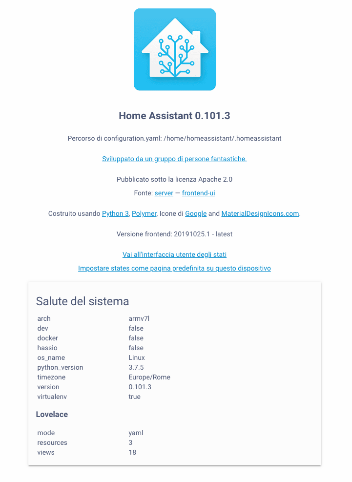

novitibo
finally this fix frontend error 404, this used cmd sequence :
1> sudo systemctl stop home-assistant
2> sudo -u homeassistant -H -s
3> source /home/homeassistant/.pyenv/versions/3.7.5/envs/homeassistant-3.7.5/bin/activate
4> pip3 install home-assistant-frontend==20191025.1
5 (optional) > pip install --upgrade pip
6> sudo systemctl start home-assistant
Many thanks to Sandro, of SDomotica, and MichaIng for suggestion and support !

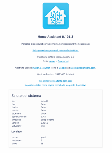

ok,
success!
