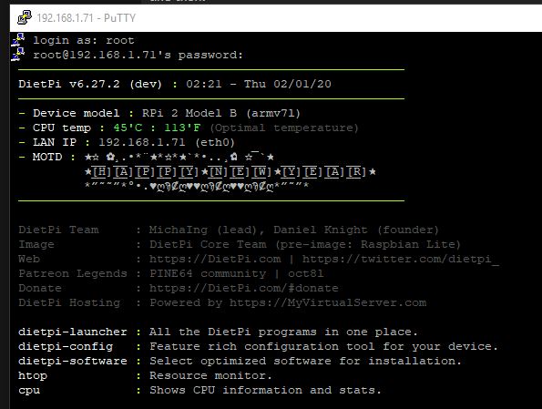

Which RPi version do you try it on and are you on DietPi v6.27.2 already?
Also please paste the error messages or logs you face in order to be able to investigate the issue. I’m currently running test installs on RPi2.
DietPi v6.27.2 (dev) version i am using
after that i used your instruction
sed -i ‘/local ha_pyenv_activation/s/source/./’ /DietPi/dietpi/dietpi-software
dietpi-software install 157
and system able to install home assistant after that & confirmed it is working properly. but still proFTP not working
