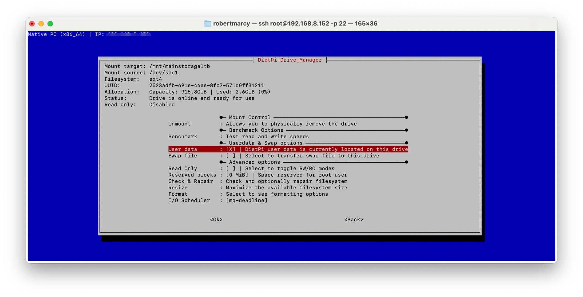

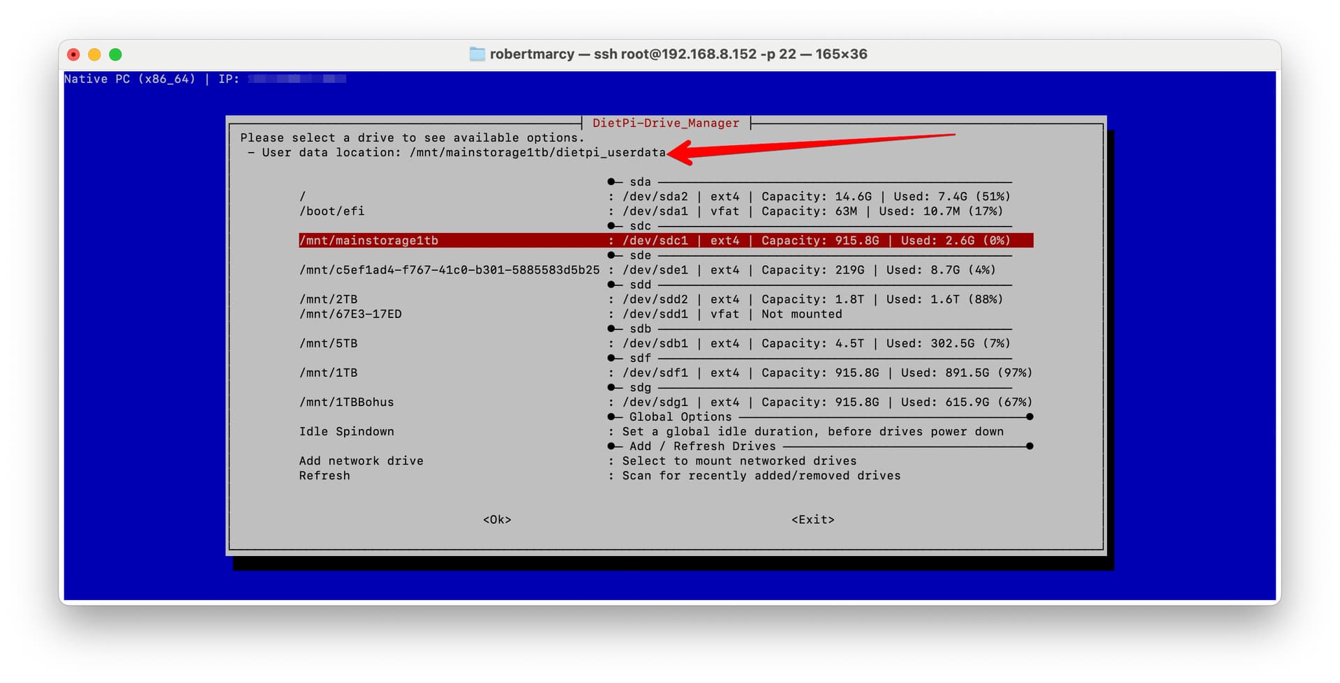

So I added a 1TB HDD to my dietpi server, formatted it as ext4 and mounted it.
then I went into the new added drive and clicked to use this drive for the diet_userdata
the move seemed to work, since my internal storage went up 2.6GB (from 6GB to 8,7GB).

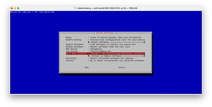

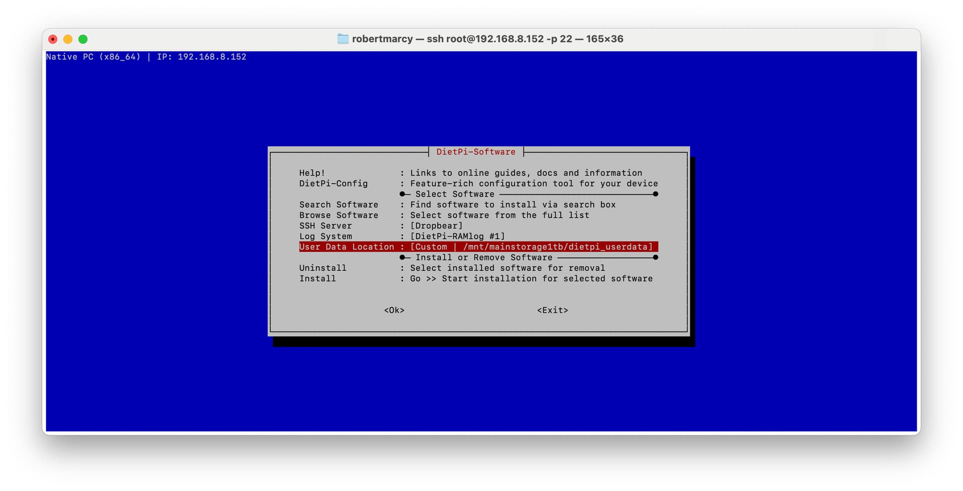

after that configuration (!!!) I installed via the software options Plex Media server and started to add my Movie and TV library. it said before installing, that the user data location is “custom” and pointed to my external 1TB Data:

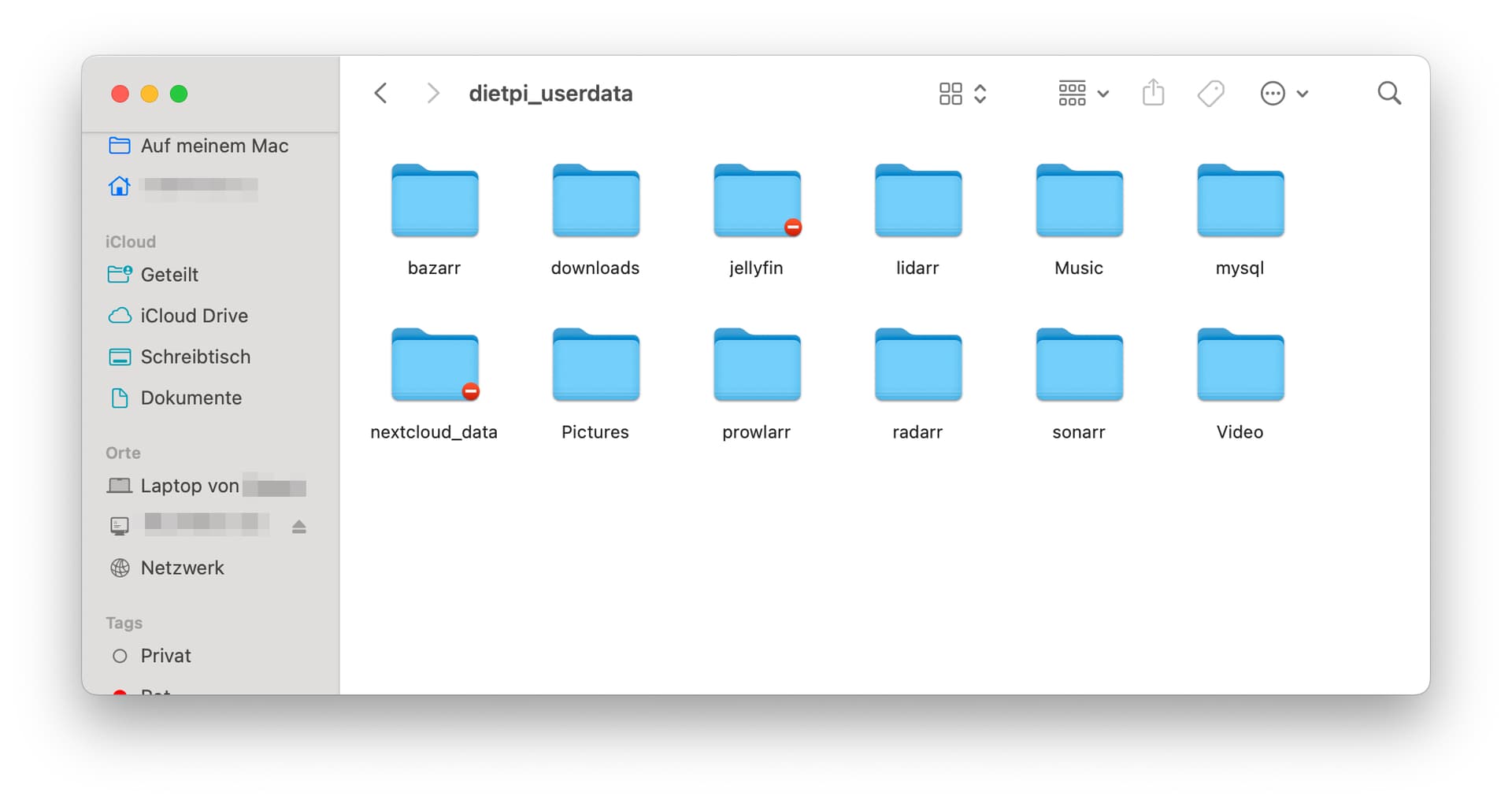

I went into my new User_data Folder on the External 1TB Drive and did not found any “Plex” folder.
