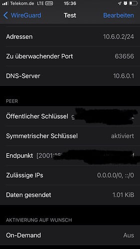

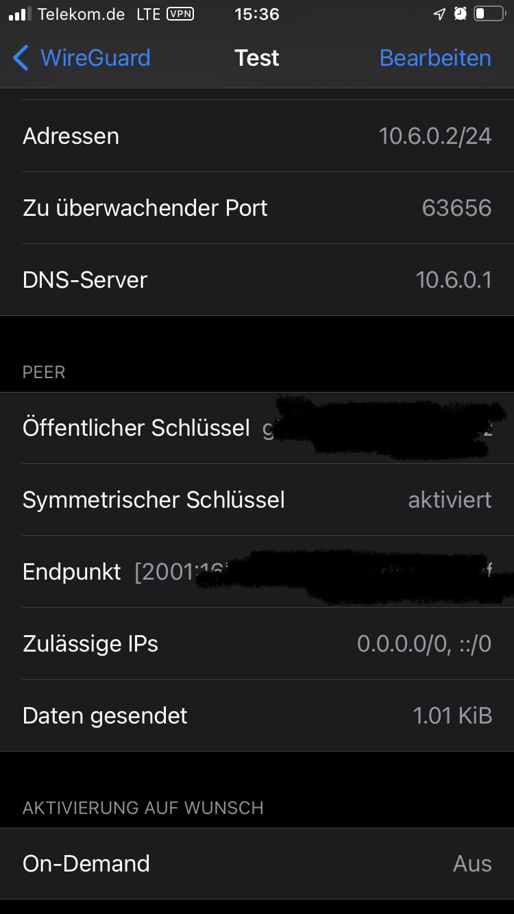

I have create a user configuration and scanned this with the Wireguard App. Then I connected with the vpn. The smartphone show me , that the VPN connection is on (VPN is shown on the display). I have create a port forwarding for ipv4 and ipv6 on my FritzBox.
The problem is, that I can’t connect to my local server or connect to the internet over the VPN. very little data was sent.
The Wireguard app will show always a connection. Even if not true. The small amount of data is indicating that the VPN connection is not established correctly. There should be a log on the client app. You could have a look to see what the app is doing. Did you forward UDP port or TCP? It should be UDP only. As well double check if your DDNS is using your correct and actually external IP address. Next to this try to create another configuration in PiVPN and scan the new QE code with your mobile phone again.

Hmm, I changed my internet connection to a different package. It looks like I no longer have ipv4 now. Maybe that is the problem. :frowning:
I have create a new config file.

2022-03-28 20:56:13.222394: [NET] peer(gU+f…KyDw) - UAPI: Removing all allowedips
2022-03-28 20:56:13.222524: [NET] peer(gU+f…KyDw) - UAPI: Adding allowedip
2022-03-28 20:56:13.222643: [NET] peer(gU+f…KyDw) - UAPI: Adding allowedip
2022-03-28 20:56:13.223330: [NET] UDP bind has been updated
2022-03-28 20:56:13.223404: [NET] peer(gU+f…KyDw) - Starting
2022-03-28 20:56:13.223514: [NET] Interface state was Down, requested Up, now Up
2022-03-28 20:56:13.223585: [NET] peer(gU+f…KyDw) - Routine: sequential sender - started
2022-03-28 20:56:13.223606: [NET] Device started
2022-03-28 20:56:13.223774: [NET] Tunnel interface is utun7
2022-03-28 20:56:13.224012: [NET] Routine: receive incoming v6 - started
2022-03-28 20:56:13.224024: [NET] Routine: receive incoming v4 - started
2022-03-28 20:56:13.224528: [NET] peer(gU+f…KyDw) - Routine: sequential receiver - started
2022-03-28 20:56:13.226682: [NET] Network change detected with satisfied route and interface order [pdp_ip0]
2022-03-28 20:56:13.226929: [APP] Tunnel 'Bkiste WireGuard' connection status changed to 'connected'
2022-03-28 20:56:13.228271: [NET] DNS64: mapped 82.xxx.236.xxx to 64:ff9b::xxcf:xxxx
2022-03-28 20:56:13.228531: [NET] peer(gU+f…KyDw) - UAPI: Updating endpoint
2022-03-28 20:56:13.228832: [NET] Routine: receive incoming v4 - stopped
2022-03-28 20:56:13.228889: [NET] Routine: receive incoming v6 - stopped
2022-03-28 20:56:13.229355: [NET] UDP bind has been updated
2022-03-28 20:56:13.229398: [NET] Routine: receive incoming v4 - started
2022-03-28 20:56:13.229418: [NET] Routine: receive incoming v6 - started
2022-03-28 20:56:13.807943: [NET] Network change detected with satisfied route and interface order [pdp_ip0, utun7]
2022-03-28 20:56:13.810227: [NET] DNS64: mapped 82.xx.236. to 64:ff9b::xxcf:
2022-03-28 20:56:13.810525: [NET] peer(gU+f…KyDw) - UAPI: Updating endpoint
2022-03-28 20:56:13.810906: [NET] Routine: receive incoming v4 - stopped
2022-03-28 20:56:13.810980: [NET] Routine: receive incoming v6 - stopped
2022-03-28 20:56:13.811677: [NET] UDP bind has been updated
2022-03-28 20:56:13.811726: [NET] Routine: receive incoming v4 - started
2022-03-28 20:56:13.811805: [NET] Routine: receive incoming v6 - started
2022-03-28 20:56:17.523146: [APP] Status update notification timeout for tunnel 'Bkiste WireGuard'. Tunnel status is now 'connected'.
2022-03-28 20:57:10.990403: [NET] peer(gU+f…KyDw) - Sending handshake initiation
2022-03-28 20:57:15.995303: [NET] peer(gU+f…KyDw) - Sending handshake initiation
2022-03-28 20:57:21.007833: [NET] peer(gU+f…KyDw) - Sending handshake initiation
2022-03-28 20:57:26.290183: [NET] peer(gU+f…KyDw) - Handshake did not complete after 5 seconds, retrying (try 2)
2022-03-28 20:57:26.290376: [NET] peer(gU+f…KyDw) - Sending handshake initiation
2022-03-28 20:57:31.469171: [NET] peer(gU+f…KyDw) - Handshake did not complete after 5 seconds, retrying (try 2)
2022-03-28 20:57:31.469305: [NET] peer(gU+f…KyDw) - Sending handshake initiation
2022-03-28 20:57:36.478251: [NET] peer(gU+f…KyDw) - Sending handshake initiation
2022-03-28 20:57:41.805467: [NET] peer(gU+f…KyDw) - Handshake did not complete after 5 seconds, retrying (try 2)
2022-03-28 20:57:41.805713: [NET] peer(gU+f…KyDw) - Sending handshake initiation
2022-03-28 20:57:46.887698: [NET] peer(gU+f…KyDw) - Handshake did not complete after 5 seconds, retrying (try 2)
2022-03-28 20:57:46.887898: [NET] peer(gU+f…KyDw) - Sending handshake initiation
2022-03-28 20:57:52.194513: [NET] peer(gU+f…KyDw) - Handshake did not complete after 5 seconds, retrying (try 2)
2022-03-28 20:57:52.194901: [NET] peer(gU+f…KyDw) - Sending handshake initiation
2022-03-28 20:57:57.338805: [NET] peer(gU+f…KyDw) - Handshake did not complete after 5 seconds, retrying (try 2)
2022-03-28 20:57:57.339023: [NET] peer(gU+f…KyDw) - Sending handshake initiation
2022-03-28 20:58:02.481103: [NET] peer(gU+f…KyDw) - Handshake did not complete after 5 seconds, retrying (try 2)
2022-03-28 20:58:02.481492: [NET] peer(gU+f…KyDw) - Sending handshake initiation
2022-03-28 20:58:07.487315: [NET] peer(gU+f…KyDw) - Sending handshake initiation
2022-03-28 20:58:12.603585: [NET] peer(gU+f…KyDw) - Sending handshake initiation
2022-03-28 20:58:17.682046: [NET] peer(gU+f…KyDw) - Handshake did not complete after 5 seconds, retrying (try 2)
2022-03-28 20:58:17.682274: [NET] peer(gU+f…KyDw) - Sending handshake initiation
2022-03-28 20:58:22.794817: [NET] peer(gU+f…KyDw) - Handshake did not complete after 5 seconds, retrying (try 2)
2022-03-28 20:58:22.795029: [NET] peer(gU+f…KyDw) - Sending handshake initiation
2022-03-28 20:58:27.869049: [NET] peer(gU+f…KyDw) - Handshake did not complete after 5 seconds, retrying (try 2)
2022-03-28 20:58:27.869465: [NET] peer(gU+f…KyDw) - Sending handshake initiation
2022-03-28 20:58:32.966724: [NET] peer(gU+f…KyDw) - Handshake did not complete after 5 seconds, retrying (try 2)
2022-03-28 20:58:32.966941: [NET] peer(gU+f…KyDw) - Sending handshake initiation
2022-03-28 20:58:37.985702: [NET] peer(gU+f…KyDw) - Handshake did not complete after 5 seconds, retrying (try 2)
2022-03-28 20:58:37.986102: [NET] peer(gU+f…KyDw) - Sending handshake initiation
2022-03-28 20:58:43.085226: [NET] peer(gU+f…KyDw) - Handshake did not complete after 5 seconds, retrying (try 2)
2022-03-28 20:58:43.085550: [NET] peer(gU+f…KyDw) - Sending handshake initiation
2022-03-28 20:58:48.168844: [NET] peer(gU+f…KyDw) - Handshake did not complete after 5 seconds, retrying (try 2)
2022-03-28 20:58:48.168999: [NET] peer(gU+f…KyDw) - Sending handshake initiation
2022-03-28 20:58:53.473584: [NET] peer(gU+f…KyDw) - Handshake did not complete after 5 seconds, retrying (try 2)
2022-03-28 20:58:53.473895: [NET] peer(gU+f…KyDw) - Sending handshake initiation
2022-03-28 20:58:58.700727: [NET] peer(gU+f…KyDw) - Handshake did not complete after 5 seconds, retrying (try 2)
2022-03-28 20:58:58.700957: [NET] peer(gU+f…KyDw) - Sending handshake initiation
2022-03-28 20:59:03.999985: [NET] peer(gU+f…KyDw) - Handshake did not complete after 5 seconds, retrying (try 2)
2022-03-28 20:59:04.001371: [NET] peer(gU+f…KyDw) - Sending handshake initiation
2022-03-28 20:59:09.069253: [NET] peer(gU+f…KyDw) - Handshake did not complete after 5 seconds, retrying (try 2)
2022-03-28 20:59:09.069571: [NET] peer(gU+f…KyDw) - Sending handshake initiation
2022-03-28 20:59:14.353862: [NET] peer(gU+f…KyDw) - Handshake did not complete after 5 seconds, retrying (try 3)
2022-03-28 20:59:14.354190: [NET] peer(gU+f…KyDw) - Sending handshake initiation
2022-03-28 20:59:19.669449: [NET] peer(gU+f…KyDw) - Handshake did not complete after 5 seconds, retrying (try 2)
2022-03-28 20:59:19.669694: [NET] peer(gU+f…KyDw) - Sending handshake initiation
2022-03-28 20:59:24.874873: [NET] peer(gU+f…KyDw) - Handshake did not complete after 5 seconds, retrying (try 2)
2022-03-28 20:59:24.875206: [NET] peer(gU+f…KyDw) - Sending handshake initiation
2022-03-28 20:59:30.008373: [NET] peer(gU+f…KyDw) - Handshake did not complete after 5 seconds, retrying (try 3)
2022-03-28 20:59:30.008734: [NET] peer(gU+f…KyDw) - Sending handshake initiation
2022-03-28 20:59:35.072850: [NET] peer(gU+f…KyDw) - Handshake did not complete after 5 seconds, retrying (try 2)
2022-03-28 20:59:35.073208: [NET] peer(gU+f…KyDw) - Sending handshake initiation
2022-03-28 20:59:40.367328: [NET] peer(gU+f…KyDw) - Handshake did not complete after 5 seconds, retrying (try 2)
2022-03-28 20:59:40.367569: [NET] peer(gU+f…KyDw) - Sending handshake initiation
2022-03-28 20:59:45.640149: [NET] peer(gU+f…KyDw) - Handshake did not complete after 5 seconds, retrying (try 2)
2022-03-28 20:59:45.640486: [NET] peer(gU+f…KyDw) - Sending handshake initiation
2022-03-28 20:59:50.864689: [NET] peer(gU+f…KyDw) - Sending handshake initiation
2022-03-28 20:59:55.895862: [NET] peer(gU+f…KyDw) - Sending handshake initiation
2022-03-28 21:00:00.900936: [NET] peer(gU+f…KyDw) - Sending handshake initiation
2022-03-28 21:00:06.056132: [NET] peer(gU+f…KyDw) - Sending handshake initiation
2022-03-28 21:00:11.088956: [NET] peer(gU+f…KyDw) - Sending handshake initiation
2022-03-28 21:00:16.213104: [NET] peer(gU+f…KyDw) - Handshake did not complete after 5 seconds, retrying (try 2)
2022-03-28 21:00:16.213606: [NET] peer(gU+f…KyDw) - Sending handshake initiation
2022-03-28 21:00:21.370627: [NET] peer(gU+f…KyDw) - Handshake did not complete after 5 seconds, retrying (try 2)
2022-03-28 21:00:21.370991: [NET] peer(gU+f…KyDw) - Sending handshake initiation
2022-03-28 21:00:26.592222: [NET] peer(gU+f…KyDw) - Handshake did not complete after 5 seconds, retrying (try 2)
2022-03-28 21:00:26.592583: [NET] peer(gU+f…KyDw) - Sending handshake initiation
2022-03-28 21:00:31.791755: [NET] peer(gU+f…KyDw) - Handshake did not complete after 5 seconds, retrying (try 2)
2022-03-28 21:00:31.792088: [NET] peer(gU+f…KyDw) - Sending handshake initiation
2022-03-28 21:00:37.044043: [NET] peer(gU+f…KyDw) - Handshake did not complete after 5 seconds, retrying (try 2)
2022-03-28 21:00:37.044395: [NET] peer(gU+f…KyDw) - Sending handshake initiation
2022-03-28 21:00:42.100933: [NET] peer(gU+f…KyDw) - Sending handshake initiation
2022-03-28 21:00:47.160698: [NET] peer(gU+f…KyDw) - Handshake did not complete after 5 seconds, retrying (try 2)
2022-03-28 21:00:47.161080: [NET] peer(gU+f…KyDw) - Sending handshake initiation
2022-03-28 21:00:52.227202: [NET] peer(gU+f…KyDw) - Handshake did not complete after 5 seconds, retrying (try 2)
2022-03-28 21:00:52.227539: [NET] peer(gU+f…KyDw) - Sending handshake initiation
2022-03-28 21:00:57.334610: [NET] peer(gU+f…KyDw) - Handshake did not complete after 5 seconds, retrying (try 2)
2022-03-28 21:00:57.334942: [NET] peer(gU+f…KyDw) - Sending handshake initiation
2022-03-28 21:01:02.642073: [NET] peer(gU+f…KyDw) - Handshake did not complete after 5 seconds, retrying (try 2)
2022-03-28 21:01:02.642304: [NET] peer(gU+f…KyDw) - Sending handshake initiation
2022-03-28 21:01:07.827394: [NET] peer(gU+f…KyDw) - Handshake did not complete after 5 seconds, retrying (try 2)
2022-03-28 21:01:07.827724: [NET] peer(gU+f…KyDw) - Sending handshake initiation
2022-03-28 21:01:13.136139: [NET] peer(gU+f…KyDw) - Handshake did not complete after 5 seconds, retrying (try 2)
2022-03-28 21:01:13.136287: [NET] peer(gU+f…KyDw) - Sending handshake initiation
2022-03-28 21:01:18.352268: [NET] peer(gU+f…KyDw) - Handshake did not complete after 5 seconds, retrying (try 2)
2022-03-28 21:01:18.352511: [NET] peer(gU+f…KyDw) - Sending handshake initiation
2022-03-28 21:01:23.576619: [NET] peer(gU+f…KyDw) - Handshake did not complete after 5 seconds, retrying (try 2)
2022-03-28 21:01:23.576778: [NET] peer(gU+f…KyDw) - Sending handshake initiation
2022-03-28 21:01:28.758406: [NET] peer(gU+f…KyDw) - Handshake did not complete after 5 seconds, retrying (try 2)
2022-03-28 21:01:28.758564: [NET] peer(gU+f…KyDw) - Sending handshake initiation
2022-03-28 21:01:34.030020: [NET] peer(gU+f…KyDw) - Handshake did not complete after 5 seconds, retrying (try 2)
2022-03-28 21:01:34.030354: [NET] peer(gU+f…KyDw) - Sending handshake initiation
2022-03-28 21:01:39.214703: [NET] peer(gU+f…KyDw) - Handshake did not complete after 5 seconds, retrying (try 2)
2022-03-28 21:01:39.214787: [NET] peer(gU+f…KyDw) - Sending handshake initiation
2022-03-28 21:01:41.095048: [NET] Stopping tunnel
2022-03-28 21:01:41.095467: [NET] Device closing
2022-03-28 21:01:41.095803: [NET] Routine: TUN reader - stopped
2022-03-28 21:01:41.096048: [NET] Routine: event worker - stopped
2022-03-28 21:01:41.096750: [NET] Routine: receive incoming v4 - stopped
2022-03-28 21:01:41.096837: [NET] Routine: receive incoming v6 - stopped
2022-03-28 21:01:41.096928: [NET] peer(gU+f…KyDw) - Stopping
2022-03-28 21:01:41.097058: [NET] peer(gU+f…KyDw) - Routine: sequential sender - stopped
2022-03-28 21:01:41.097082: [NET] peer(gU+f…KyDw) - Routine: sequential receiver - stopped
2022-03-28 21:01:41.097980: [NET] Device closed
2022-03-28 21:01:41.098164: [NET] Routine: decryption worker 1 - stopped
2022-03-28 21:01:41.098159: [NET] Routine: handshake worker 5 - stopped
2022-03-28 21:01:41.098197: [NET] Routine: handshake worker 3 - stopped
2022-03-28 21:01:41.098227: [NET] Routine: decryption worker 2 - stopped
2022-03-28 21:01:41.098287: [NET] Routine: handshake worker 4 - stopped
2022-03-28 21:01:41.098316: [NET] Routine: handshake worker 1 - stopped
2022-03-28 21:01:41.098360: [NET] Routine: handshake worker 6 - stopped
2022-03-28 21:01:41.098421: [NET] Routine: decryption worker 3 - stopped
2022-03-28 21:01:41.098445: [NET] Routine: decryption worker 4 - stopped
2022-03-28 21:01:41.098473: [NET] Routine: decryption worker 6 - stopped
2022-03-28 21:01:41.098523: [NET] Routine: handshake worker 2 - stopped
2022-03-28 21:01:41.098591: [NET] Routine: decryption worker 5 - stopped
2022-03-28 21:01:41.098963: [NET] Routine: encryption worker 1 - stopped
2022-03-28 21:01:41.099000: [NET] Routine: encryption worker 2 - stopped
2022-03-28 21:01:41.099069: [NET] Routine: encryption worker 6 - stopped
2022-03-28 21:01:41.099094: [NET] Routine: encryption worker 5 - stopped
2022-03-28 21:01:41.099096: [NET] Routine: encryption worker 4 - stopped
2022-03-28 21:01:41.099206: [NET] Routine: encryption worker 3 - stopped
2022-03-28 21:01:43.916336: [APP] Tunnel 'Bkiste WireGuard' connection status changed to 'disconnected'
IPv6
2022-03-28 22:14:56.283415: [APP] startActivation: Entering (tunnel: Bkiste WireGuard)
2022-03-28 22:14:56.288654: [APP] startActivation: Starting tunnel
2022-03-28 22:14:56.293984: [APP] startActivation: Success
2022-03-28 22:14:56.309402: [APP] Tunnel 'Bkiste WireGuard' connection status changed to 'connecting'
2022-03-28 22:14:56.594495: [NET] App version: 1.0.15 (26)
2022-03-28 22:14:56.595097: [NET] Starting tunnel from the app
2022-03-28 22:14:56.912264: [NET] DNS64: mapped 2001:16b8:2903:a8a1:de15:xxx to itself.
2022-03-28 22:14:56.913362: [NET] Attaching to interface
2022-03-28 22:14:56.913918: [NET] UAPI: Updating private key
2022-03-28 22:14:56.913962: [NET] Routine: encryption worker 4 - started
2022-03-28 22:14:56.914063: [NET] Routine: handshake worker 2 - started
2022-03-28 22:14:56.914080: [NET] Routine: decryption worker 2 - started
2022-03-28 22:14:56.914117: [NET] Routine: handshake worker 1 - started
2022-03-28 22:14:56.914138: [NET] Routine: encryption worker 3 - started

basically your client is not able to connect to server
2022-03-28 22:15:23.549727: [NET] peer(gU+f…KyDw) - Handshake did not complete after 5 seconds, retrying (try 2)
2022-03-28 22:15:23.550064: [NET] peer(gU+f…KyDw) - Sending handshake initiation
Are you sure you have an external IPv6 address only? No IPv4? Does your DietPi device is using IPv6 as well?
Dear Joulinar,
this was the error. My internet connection had only DS-Lite. Thereby only one IPv6 is assigned. You don’t get a real IPv4 anymore. My provider has now changed this on request and I have a real IPv4 again. Now WireGuard also works. The Ordroid has also not been assigned an IPv6 in the configuration of WireGuard. Maybe it would have worked that way.
thank you very much for your patience and your help!
ok, good you could solve it with your ISP
