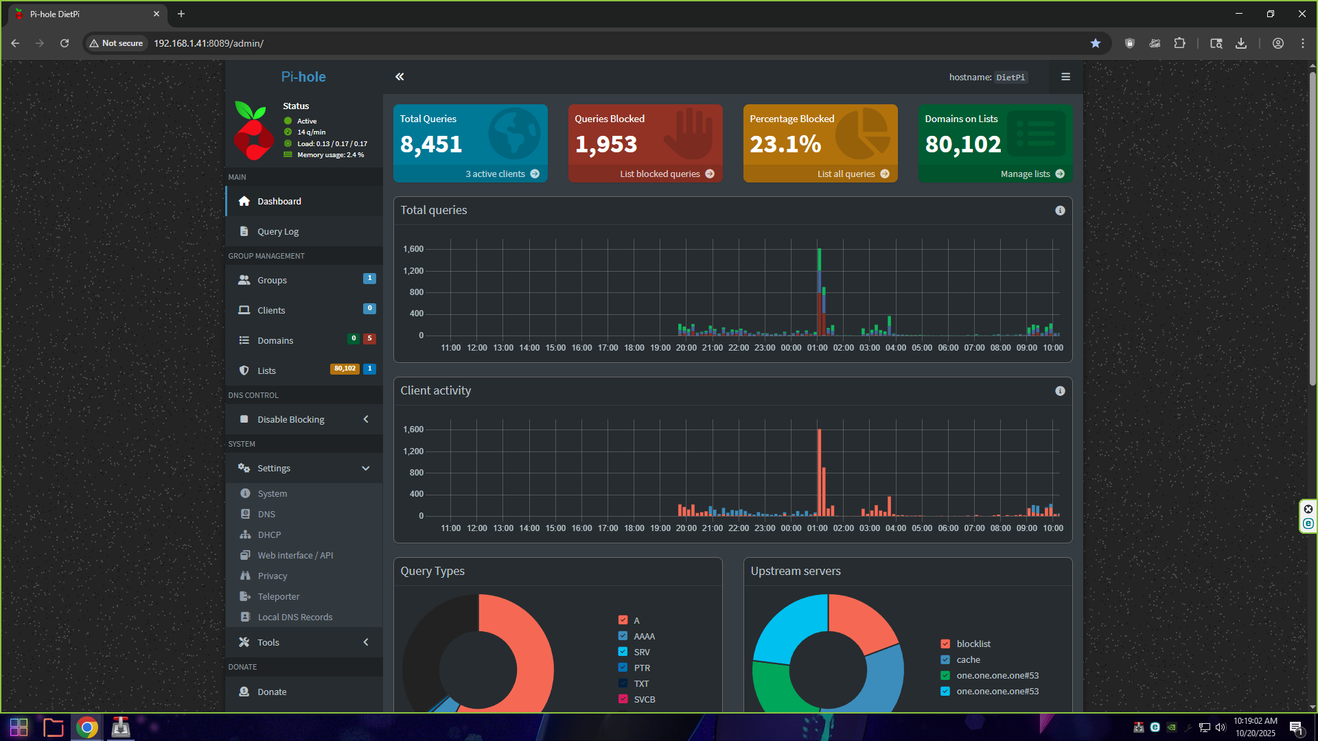

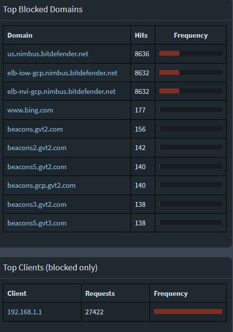

i keep getting bitdefender update requests in pihole but i dont have it installed on any machine and im getting constant dns requests. from us.nimbus.bitdefender.net i asked bit defender customer service and they are almost useless. they keep thinking dietpi has bitdefender on it. is there something that would be falsely showing it as bit defender? im tired from trying to figure this out. ive been doing nothing but time wasting
DietPi has nothing to do with Bitdefinder. We do not provide an antivirus solution. A new DietPi system is almost empty, as we want to run as few services as possible. Normally, you can see the client connected to the DNS request in PiHole. Is that the case for you?
yes thats what i thought and thats how it is for me. i figured it would be useless asking them for anything..nothing like the feeling of everything being futile. you guys are always on point.
EDIT: wait client? you mean the specific device making the request? no actually all my requests are one ip the router. so i cant really tell what device..
In the pihole DNS settings you can use conditional forwarding to show the individual client IP fpr the requests instead of the top client (router) they are connected to. You probably need to activate “experts settings” in the top right corner of the page. There is also a example config in the explanatory text.
Otherwise it’s pretty hard to figure out what is going on, especially if you have a lot of clients conneced.

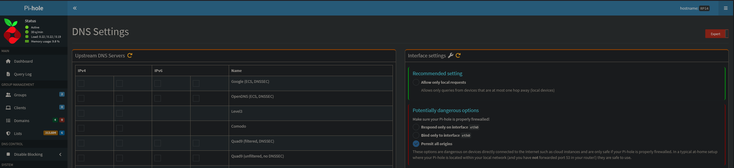

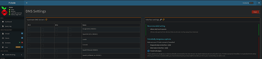

how do i adjust them? the software for this router is making me want to toss it in a poo pile..the stupid settings are in a small slide window instead of the full page so you can only see a small amount of it..like 10 to 20% of the settings.. i dont get how this was allowed to be put into a router..
on the bottom are the settings for the conditional forwarding, there is a example setting:
A valid config line could look like true,192.168.0.0/24,192.168.0.1,fritz.box
<enabled>,<ip-address>[/<prefix-len>],<server>[#<port>][,<domain>]
So for me it looks like true,192.168.178.0/24,192.168.178.1#53,fritz.box because my network is 192.168.178.0 and the router has the ip 192.168.178.1. DNS is running on port 53, so if you didn’t change it you can also use #53 or ommit it, since it’s the default value. And at the end ist the host name / domain of your router.
