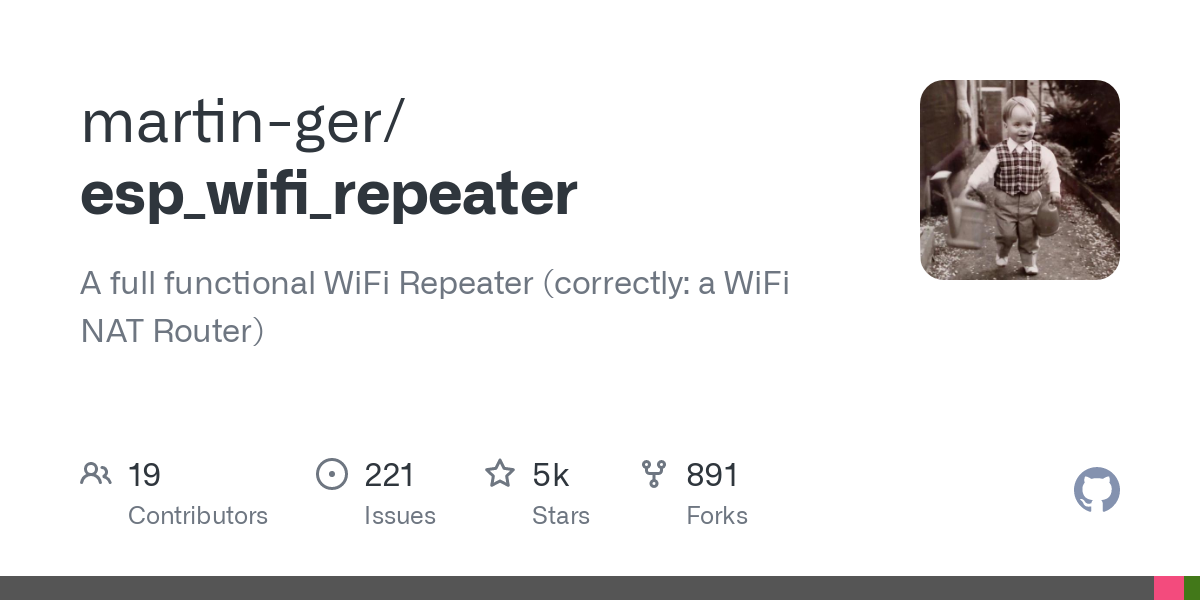

This guy did it with a simple ESP01 and it works flawlessly…
