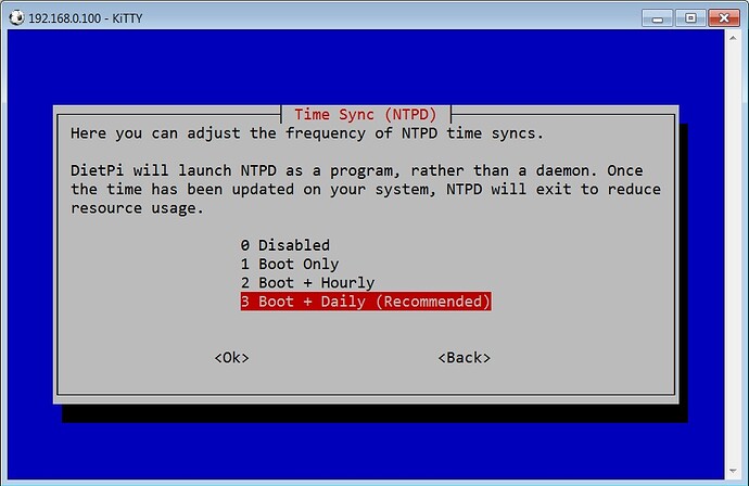

I would like to get the clock on the rpi set so that it doesn’t drift. I’m using the rpi for a timing application over a wide temperature range and just having the clock updated once per day with a cron job is not going to cut it as the drift is significant.
So I would like to have ntp running all the time.
If I run nptd from the command line, it starts and runs.

My rpi is headless and I’m using ssh.
So my problems and questions and remember that I am a beginner here:
- What is the best way to start ntp at boot and set the clock?
- Can I just remove the ntp lines in the daily cron job and not break anything else?
- When i run ntp from the command line the drift file does not get updated. ntp is running under root and the drift file is owned by ntp. I don’t know if that is the problem or not with my ignorance.
- Is there a place that errors (like file permissions) would show up? I have logging turned on, but there is little that I see in the /var/log area.
- loopstats and peerstats start to show in the /var/log/ntpstats dir, but they get deleted every few minutes by something so that I only have 0 to 5 last entries. I was expecting a full day per file of data that I could look at.
- There is no clockstats file - should there be in ntp client mode?
Any other pointers that I may be missing?
