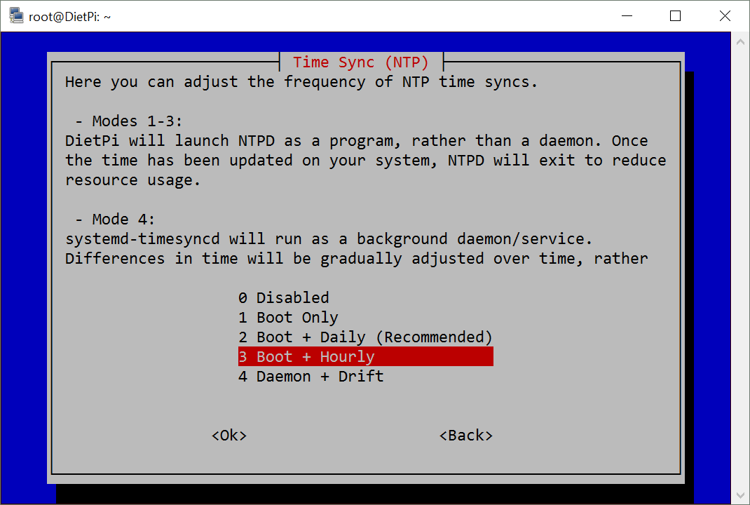

@Fourdee Has there been any major changes to ntp since this? To change the time server that is synced to; I would simply edit /etc/ntp.conf?
Yes, if using modes 1-3:
Daemon mode (4) has now been changed to SystemD-Timesyncd.
Status:
timedatectl status
Config:
/etc/systemd/timesyncd.conf
Any plans to bring back ntpd as a daemon option (mode 5 maybe)? Would make things easier for those of us running a time server under DietPi…
I think we will not bring NTP back, as we just removed it completely from DietPi code for v6.9: https://github.com/Fourdee/DietPi/pull/1628
Systemd-TimeSyncd is enough in most cases an pre-installed on every Debian based image.
But it is most easy to do time sync via another application, aside from DietPi.
  • Go to DietPi-Config > Advanced Options > Time sync mode and choose “0 Disabled”.
  • Then install NTP via APT: apt install ntp
    It will create a service that starts on boot automatically. DietPi cron job will not interfere then with this.
If NTP is already installed and adjusted by DietPi, it might be necessary to purge it once and reinstall it: apt purge ntp
