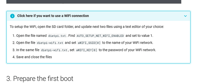

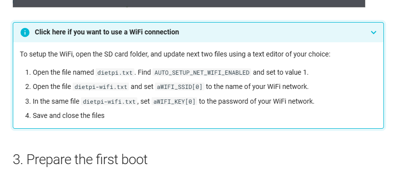

  1. Open the file named dietpi.txt. Find AUTO_SETUP_NET_WIFI_ENABLED and set to value 1
  2. Open the file dietpi-wifi.txt and set aWIFI_SSID[0] to the name of your WiFi network.
  3. In the same file dietpi-wifi.txt, set aWIFI_KEY[0] to the password of your WiFi network.
  4. Save and close the files
