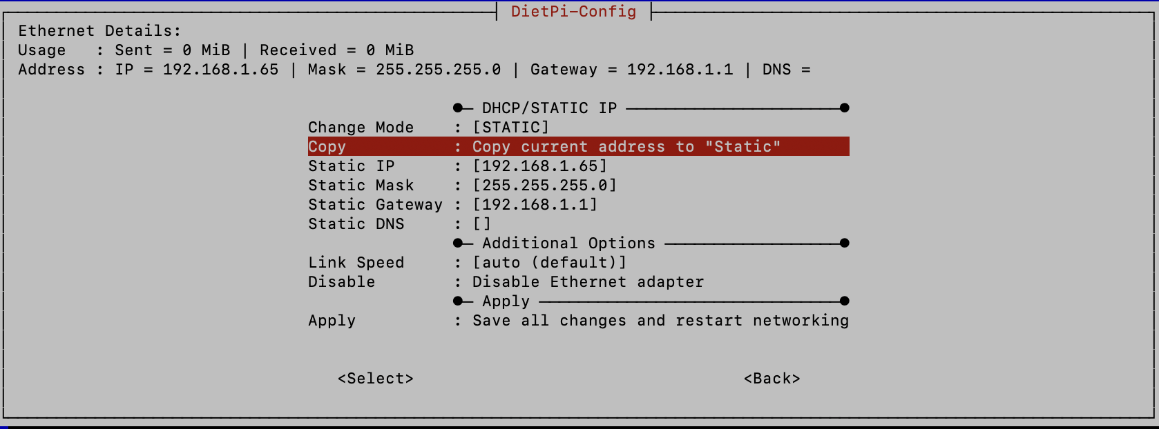

In my router (192.168.1.1 fritzbox) Pihole (192.168.1.99) is set as DNS server. I tried in dietpi both ip addresses as dns server…
what about this
did you find the test/log for the google domain we did?
No.
In the config I can’t see the DNS server.
