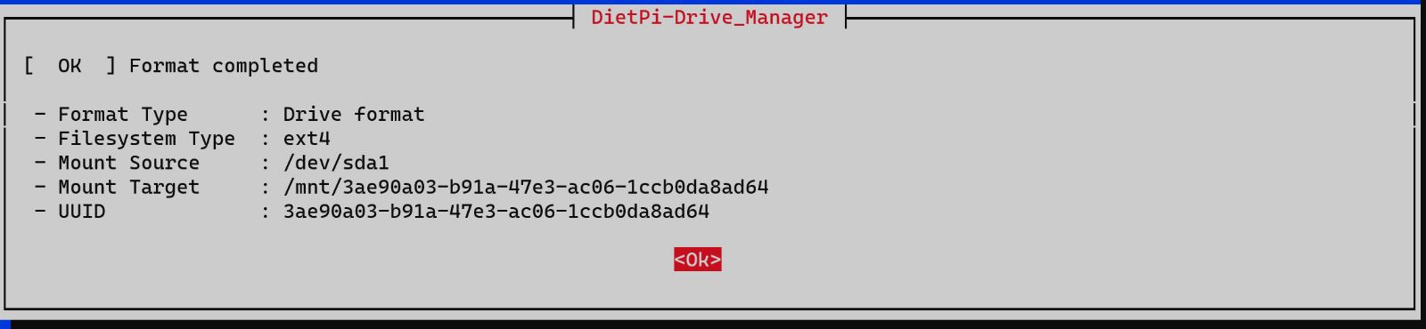

Are you willing to share some more words instead of posting a screenshot only?
Sorry!
Ofcourse Joulinar…
Was on my way out to the Awakenings festival and I forgot to enter the Send button :smiling_face:
