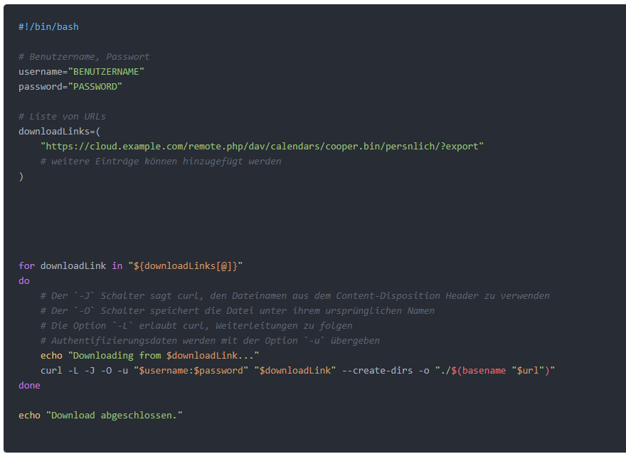

I found another script that can export contacts and calendars via WebDAV. It is much leaner and exports contacts directly to ICS and calendars to VCF files. It is written in German, but should still be understandable.
It can be found hiere: Nextcloud Backup - Kontakte und Kalender sichern
Would this be an option?
