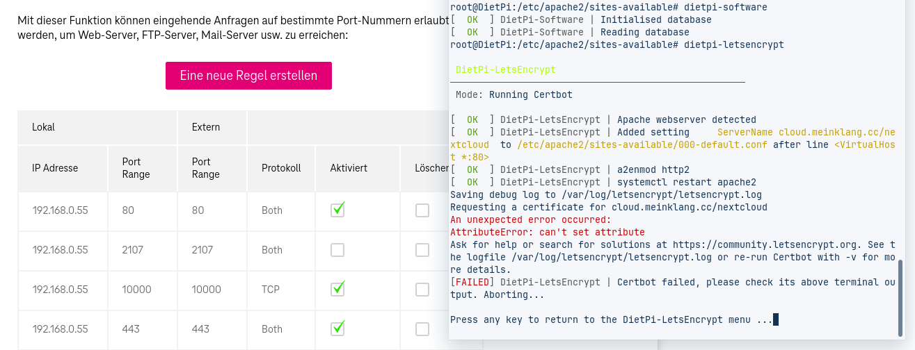

my “NextCloud” is running in the living room on https://192.168.0.55/nextcloud.
For mail I have access to a hosted DNS there I created a new DNS entry (cloud.xxx.com:7777/nextcloud ) which points to my private IP.
when I now run “dietpi-letsencrypt” I receive some error messages →

Saving debug log to /var/log/letsencrypt/letsencrypt.log
Requesting a certificate for cloud.xxx.com:7777/nextcloud
Certbot failed to authenticate some domains (authenticator: apache). The Certificate Authority reported these problems:
  Domain: cloud.xxx.com
  Type:   connection
  Detail: 84.1x.x.x: Fetching http://cloud.xxx.com/.well-known/acme-challenge/rhTIKZyDH7ZOuKirbTv7hBn1eYWZVZr37aLcvxAt5dE: Error getting validation data
Hint: The Certificate Authority failed to verify the temporary Apache configuration changes made by Certbot. Ensure that the listed domains point to this Apache server and that it is accessible from the internet.
Some challenges have failed.
Ask for help or search for solutions at https://community.letsencrypt.org. See the logfile /var/log/letsencrypt/letsencrypt.log or re-run Certbot with -v for more details.
[FAILED] DietPi-LetsEncrypt | Certbot failed, please check its above terminal output.
I lov IT - but sometimes it is really complicated
KR Karl
you need to forward port 80/443 on your router to your DietPi system
is your Apache running on port 7777? LetsEncrypt will expect your system on port 80/443 as these are regular http ports.
My Apache (installation via Dietpi-Software) is normaly running on Port 80. But to gain access from outside and not tu use standard ports I defined 7777 which is the EXTERNAL port on my ADLS Router… it is of course forwarded to 80 internal. Should I change this?
You need to forward port 80, otherwise letsencrypt can not create and renew you certificate.
When you are already at this step you could also switch everything to port 80/443 and rewind the forwarded port 7777.
Yes, as stated by @Jappe, go with standard ports.
I am too silly… I found Youtube video in which they recommend NGINX Reverse Proxy Manager. Could this one make my life easier? And is it not in conflict with apache?
KR Karl
I think this is because meinxxxx.cc is a webspace at my Internet-Provider. And I have access to a public DNS there… So I “invented” a subdomain (cloud.meinxxxx.cc) and this one points at my private apache behind the router… So meinxxx.cc and cloud.meinxxxx.cc are on complete different sites.
NPM will not change anything. It will require port 80/443 to be open and reachable from internet, same as Apache. And yes NPM is conflicting with Apache, means Apache need to be moved to a different port.
However both scenario are manageable.
Keep in min NPM requires additional system resources as it’s a docker container.
At least I managed it… Solution : although nextcloud is running on ip/nextcloud I only had to enter the domain name into th letsencrypt tool… Now I have this… super and thank you so much.
