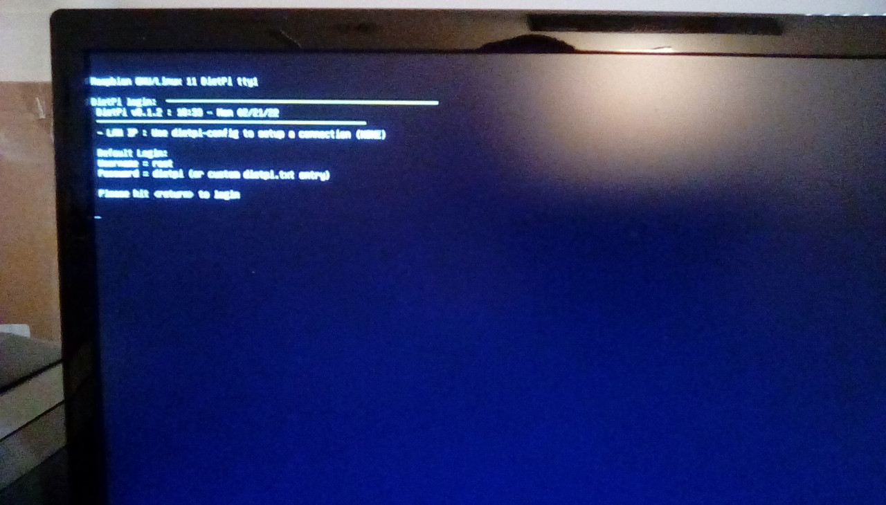

When I say “nothing” I meant I get to here the screen says ‘hit enter’ and nothing happens. I can hit it 10,000 times and not a thing would happe.
Here is the image.
Here is the image.
you need to type the user/password. Typing the user name will be visible, but password is hidden.
I just tried it both ways. The screen says 'hit enter to login" i did that and the screen stays the same. I rebooted and entered name and password
the same thing the screen propmt just stays there. So something strange is going on.
while typing the user name, you should see something. Do you? If not, the keyboard is not working or at least nothing is reaching the RPi.
Yes I see nothing. It is and brand new keyboard just the other day I recieved. It works on my PC. Oh well. Thanks for all your help I think this is just a lost cause.

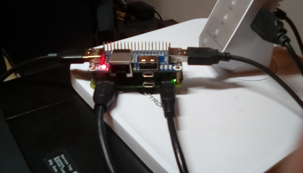

Btw, did you tried to change PSU and/or USB cable? Or do you have another adapter to connect the keyboard? Where did you connect the keyboard to? Can you do a picture?

Here is the image pf the Pi
Upper left is the Keyboard Connection
Lower left is the HDMI
Upper right is an USB to Ethernet. My onboard ethernet on the zero housing broke. That was fairly recent though.
Lower Right power.
I know the usb to ethernet works as I have been using it fine. Plus like like I stated that was a week or two ago and I never could get dietpi working.
Probably power supply isn’t sufficient for that HAT and all devices. Do you have a micro USB to USB adapter so that you are able to boot it without the HAT (and WiFi) and see whether the keyboard works then?

One indicator for insufficient voltage is a rainbow coloured square during boot on the screen, probably you see one? AFAIK it is a smaller one at the top right of the screen, not the full screen square.

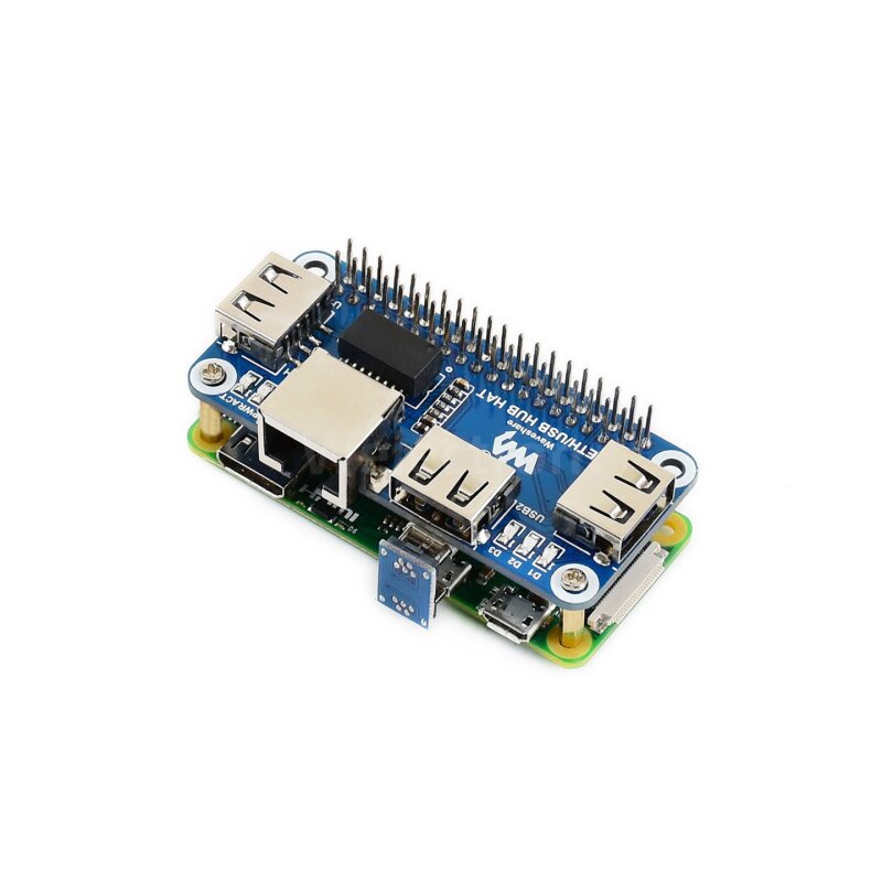

looking to this picture https://www.welectron.com/media/image/product/11009/lg/waveshare-16595-eth-usb-hub-hat~2.jpg
there should be a connector between pi zero and hat. Could that be? That might be the reason why your keyboard is not working.
The ethernet hat never came with a connector and I do not have one. I am a noob and just assumed everything happened between the 40 pin connector.
to be able to use USB ports on the hat, you would need to have the connector. And usually it should be part of the waveshare kit. Basically you could remove the hat ![]()
