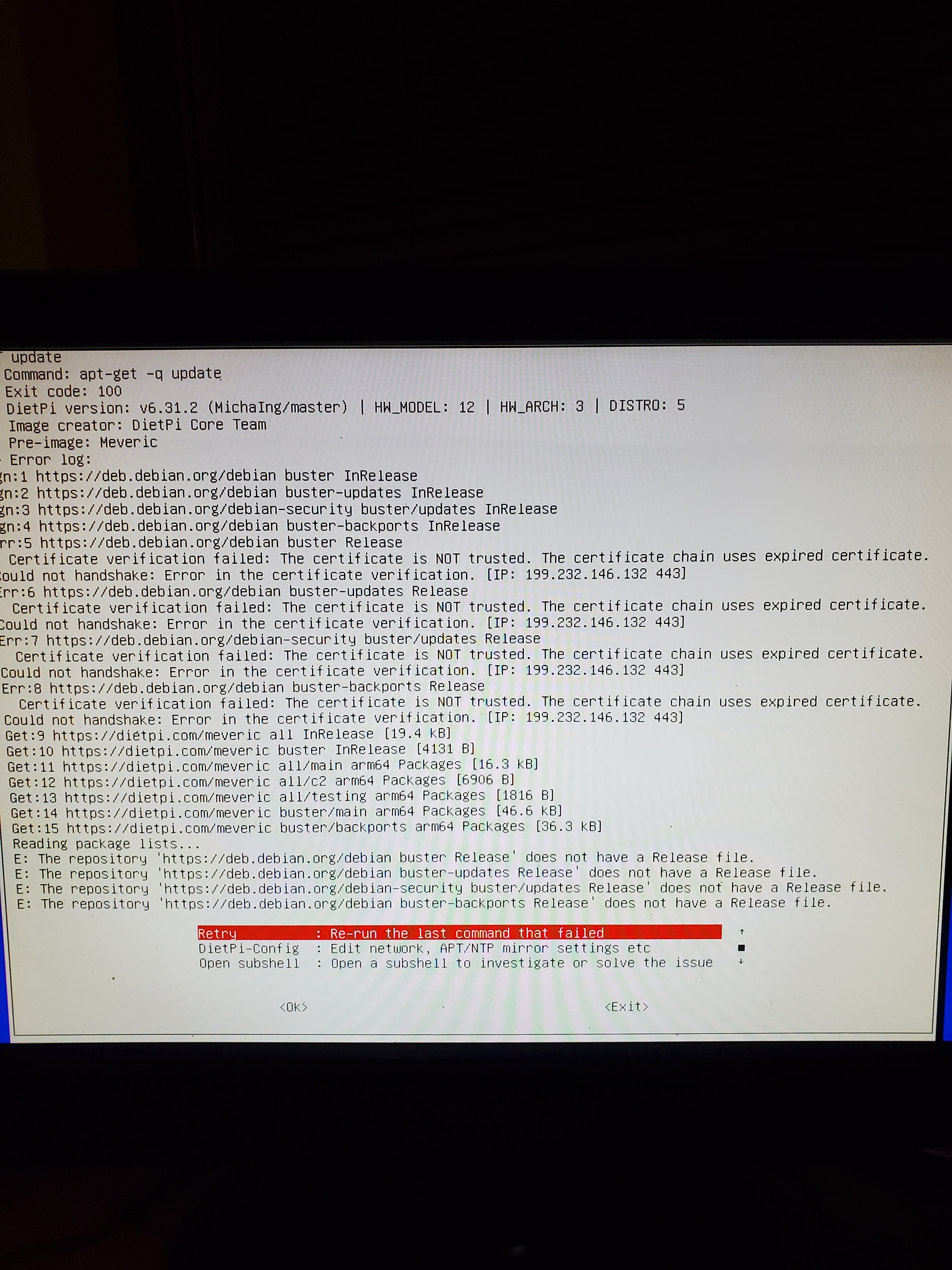

um now ive wiped my sdcard and im now unable to reinstall dietpi as it says it cant handshake or something… its after i log in with root/dietpi then it says a bunch of stuff that goes by to quick and asks me if i want to retry something that failed…
It is impossible to help you, if you don’t share real error message or logs.
it didnt give me an error it just asked me to retry apt get update because it failed something and it couldnt trust a certificate. when i go back to it tomorrow ill post some kind of error or a screenshot/log.
if there are certificate issues, you maybe running out of time sync.
Yes a log and or screen print would be helpful.

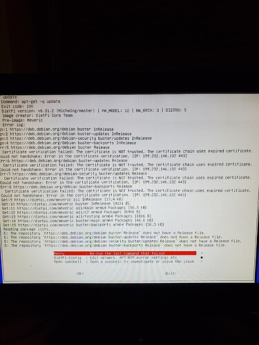

Okay I think I added a capture of the error.
Ok that’s a known issue at Debian server side. Pls try follow
sed -i 's/https:/http:/' /etc/apt/sources.list
apt update
apt upgrade
sed -i 's/http:/https:/' /etc/apt/sources.list
apt update
After it does the error I put that in? Glad it’s a known problem…I thought I broke it. Heh :slight_smile:
Just login to command line and execute the commands. Once completed you are ok to run dietpi-update
