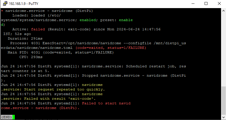

Navidrome not booting
After installtion of the application it was working and after some time the application is not working.
Please find attached the status using command status given in the docs

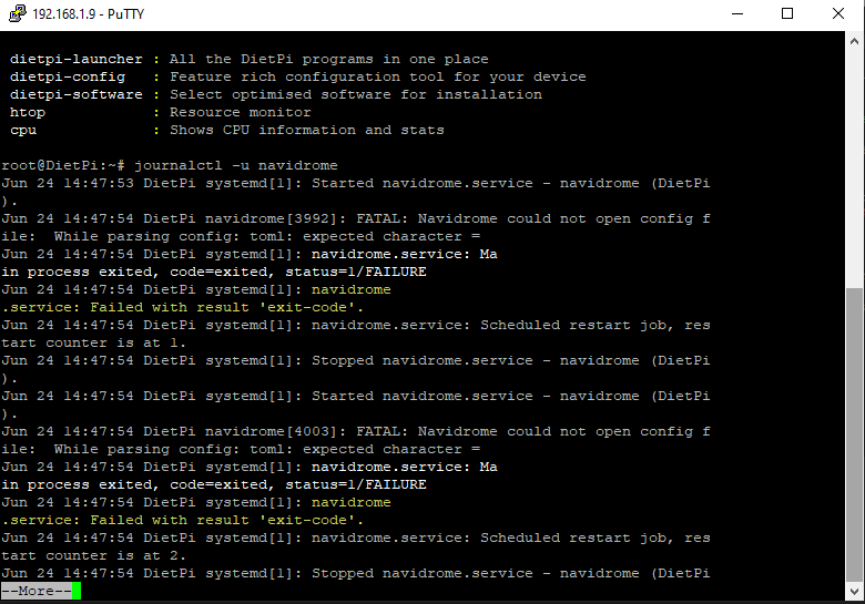

What is the output of
journalctl -u navidrome
PFA
you should be able to copy everything from SSH terminal (putty) directly. No need to do screen prints.
Anyway something happen to your config file, as you can see on one of the lines within your log.
Did you add or changed anything within the toml file?
root@DietPi:~# journalctl -u navidrome
Jun 24 14:47:53 DietPi systemd[1]: Started navidrome.service - navidrome (DietPi
Jun 24 14:47:54 DietPi navidrome[3992]: FATAL: Navidrome could not open config f
ile:  While parsing config: toml: expected character =
Jun 24 14:47:54 DietPi systemd[1]: navidrome.service: Ma
in process exited, code=exited, status=1/FAILURE
.service: Failed with result 'exit-code'.
Jun 24 14:47:54 DietPi systemd[1]: navidrome.service: Scheduled restart job, res
tart counter is at 1.
Jun 24 14:47:54 DietPi systemd[1]: Stopped navidrome.service - navidrome (DietPi
Jun 24 14:47:54 DietPi systemd[1]: Started navidrome.service - navidrome (DietPi
Jun 24 14:47:54 DietPi navidrome[4003]: FATAL: Navidrome could not open config f
tart counter is at 2.

Yes i edited the music folder path and also added the client id and secret id fir spotify.
But after that also navidrome server was working for while
