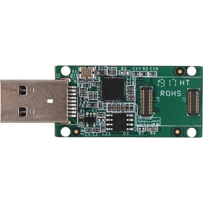

Bit late to the party, but I just successfully flashed the eMMC with this adapter by Radxa
Worked like a charm!
