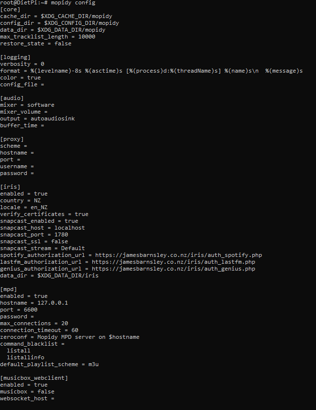

I have problems to find config file where I can set Spotify account settings. When I run mopidyctl config I can my settings, but where to adjust them? /etc/moody/mopidy.conf file is not filled with same info. If someone can point my to correct direction would be appreciated.

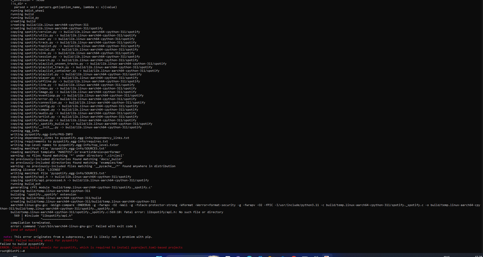

I have seen that mpd.conf but it’s empty. I added Spotify lines there. When I try to install Spotify there comes error message below.
error originates from a subprocess, and is likely not a problem with pip.
ERROR: Failed building wheel for pyspotify
Failed to build pyspotify
ERROR: Could not build wheels for pyspotify, which is required to install pyproject.toml-based projects
Can you share the whole output? Usually error message should be longer.

Hi, back to original problem how/where I can access these settings what is the pic which I attached?
/etc/mopidy/mopidy.conf don´t include these plus that mpd.conf file is empty.
Hi, does this help?
First, try to avoid doing screen prints. If possible, connect via SSH and copy relevant information from terminal directly. Thx for understanding.
Are you running a Raspberry Pi device? You are missing libspotify/api.h library which needs to be installed in addition.
