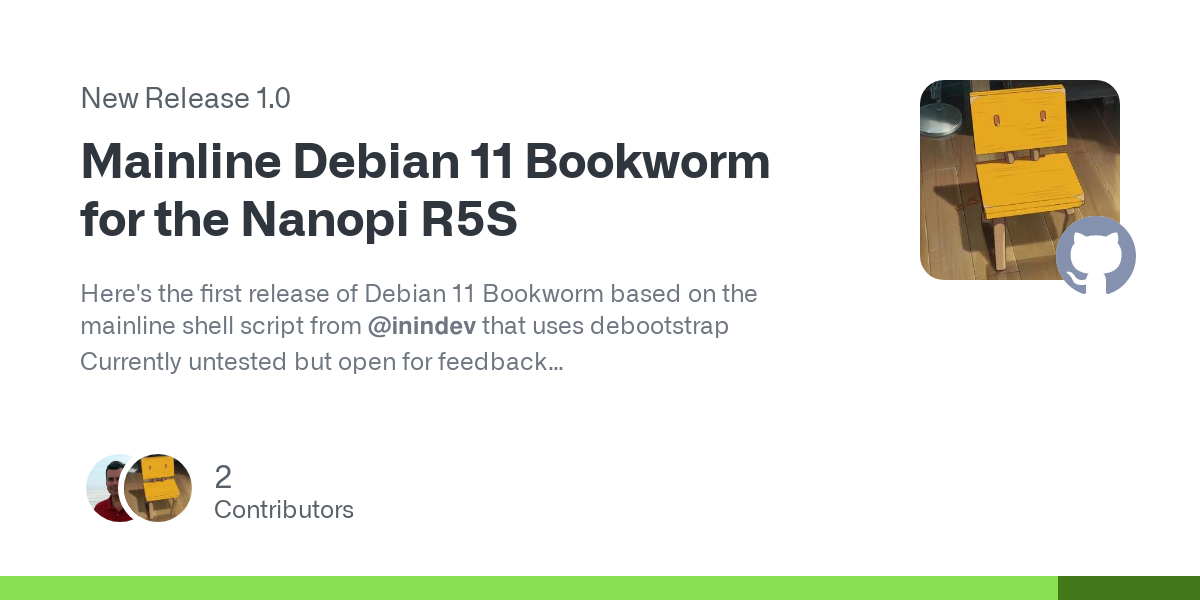

I made a bullseye image can you test it?
I tested on my R5S. It did not start. With or without masking the ROM, it does not start.
I tested on a SD card. Can it be the reason ? Is it necessary to copy it on the eMMC ?
I have the 4G RAM variant, with a 128GB SSD inside.
eMMC is not necessary. Can you read UART or do you see any HDMI output or does it straight up not work?
Unfortunately I have not cable ready to read UART. I have no HDMI output (black screen, nothing, not the blinking cursor). My SD card is 16GB. Is this too small ?
Nope I think I’ve found the issue my build accidentally used the default Kernel with Debian 11 which is 5.10 that doesn’t have the RK3568 support. Will try to fix and update

I’ve build a new image here Release Debian 11 Bullseye with Linux Kernel 6.1 · HeyMeco/NanoPi-R5S-Images · GitHub . Still needs to be tested but I got the hint from sbc-bench who built their image under the same parameters. There’s also Kernel-Headers included so hopefully this will fix that issue for you too
