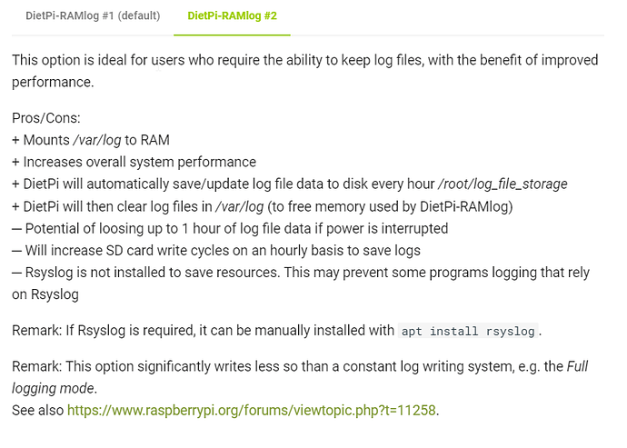

Maybe I misunderstood documentation here, but I wanted to use ram_log #2 as mentioned above, not #1 (only mentioned for completeness). this log is stored permanently on disk every hour. Am I wrong here?
What we do is quite simple. Copy everything that is available in /var/log to /root/logfile_storage. If there is no /var/log/syslog, it will not be copied. For this you might need to install rsyslog. The logs are moved once a hour. The execution time for all our jobs can be adjusted using dietpi-cron

DietPi don’t has own logs. The base OS is using journald for majority of logs. And some application doing logs down to /var/log by it’s own. However we try to to configure most of them to use journald.
You could try to install rsyslog if you need /var/log/syslog. This should be possible on all logging options.
