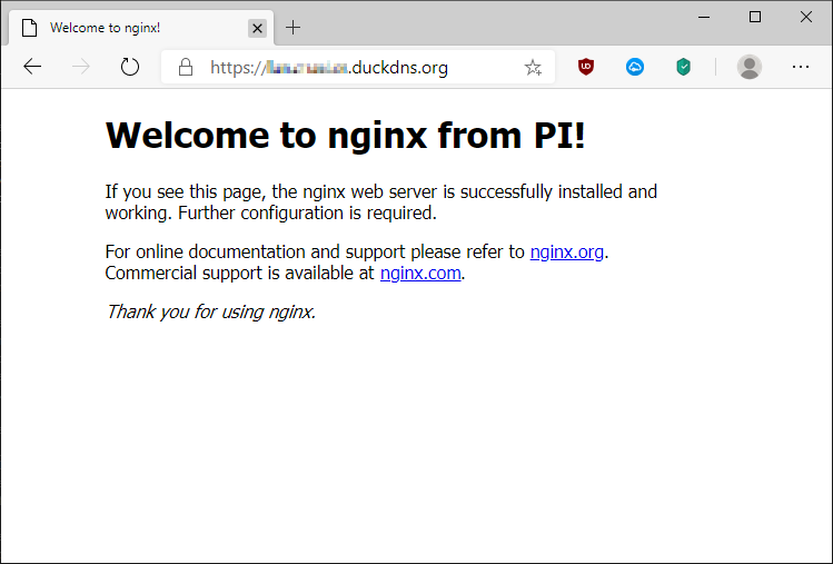

which web server you are using? Because I can see nginx if I try to open the ddns your are posted below.

well but this is what it tells me if I try to connect to your side. See attached picture

This is very strange :smiley:
Here is the processes related to www
When I open the url I only get the certificate error, something fishy :smiley:
I’ll PM you the url, and tks for changing on my post :wink:
I guess you can accept the error message and continue to the website itself.
Strange that you did not have nginx running but the default web page is showing nginx. Unusual it should show default page from lighttpd :thinking:
