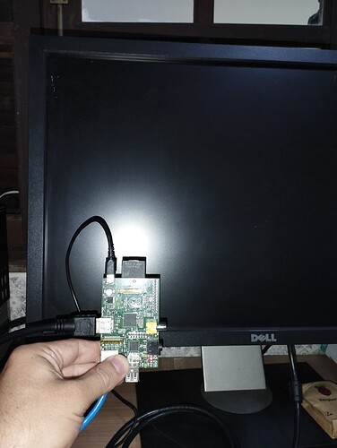

It does not boot, I have the screen connected.
The screen goes completely black.
And the SBC board works perfectly with an image of the RaspBerry Pi OS itself.
Only with DietPi it doesn’t work, but I would like it to work because I’m in love with DietPi

even if the screen stays blank, did you checked on your router if an IP address has been assigned?
The raspberry does not boot. I perceive it by the led’s

The first one. That’s the one for RPi1. Pls can you answer my question if you update RPi OS to the latest version using apt update && apt upgrade
I don’t have access to the operating system to update the package.
I can not do that.
I mean the RPi OS image you tested and that seems to have been working fine.
With Raspberry pi Os ia working fine
But was dietpi OS is not work
With DietPi OS is not working …
