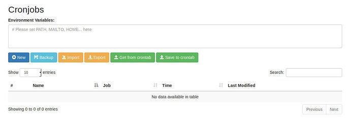

Do You know what to do to fix that:
Operation failed: Internal Server Error. Please see error log for details.
When I try to add entry to crontab in that crontab-ui. Meybe it don’t have permissions to add jobs to cron?
