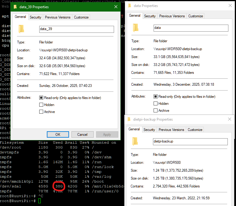

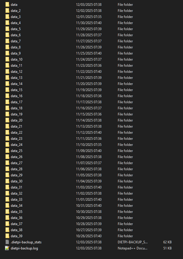

  • each data_* folder in dietpi-backup should contain a full backup around ~33GB each
  • 10-12 backups should fill the drive and then rollover after each backup
  • each data_* folder size reported correctly around ~33GB
  • dietpi-backup does not create a full backup.
  • Each folder appears to be an incremental backup?
  • however the total size of dietpi-backup folder is reported around ~1.24TB… uhhh what?!?

Screenshot 2025-12-03 180700
It came with v9.17
DietPi-Tools | DietPi-Backup If multiple backups are created (and kept), the rsync --link-dest option is now used to create files which did not change between last and current backup iteration as hard links to the last iteration. This usually leads to massively reduced effective disk usage and backup speedups, since unchanged files do not need to be copied, while every backup iteration however remains fully self-contained. Many thanks to @nicojx for making us aware of rsnapshot, which uses the same technique: MichaIng/DietPi?7711
There is no way back, why would you wanna go back?
I guess Windows does not handle ext4 with hard links well. 33GB * 39 is roughly 1.2 TB, but in fact, you have only stored files “worth” of 39GB. You can now save a lot more backups, I don’t get why you want the old behavior back :sweat_smile:
