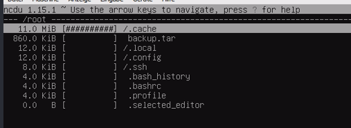

even with “sudo ncdu” I cannot get dietpi to show my largest folders:
ncdu

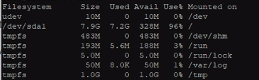

but apparently my drive runs full:
ncdu 2
Just check above Disk Usage Analyser - #3 by Joulinar

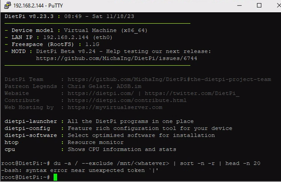

sorry for being silly:
error dietpi 2
du -a / --exclude /mnt/<whatever> | sort -n -r | head -n 20
The --exclude /mnt/<whatever> is an example of you want to exclude some folders, the < throws the error. Remove the exclude part of you don’t want to exclude anything
You need to adjust the command on your needs as described above. There are wildcard and thinks you might remove

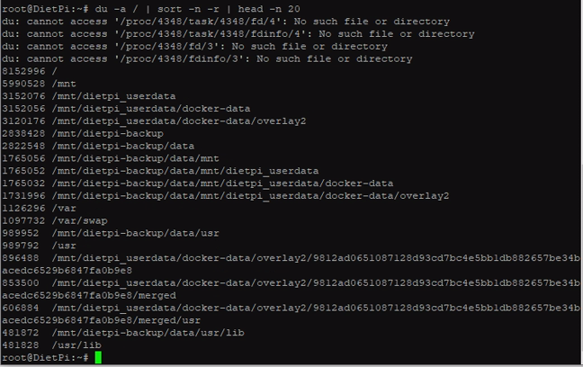

that did the trick. but what do I do with the output?
error 3
I would like to know which folder is the culprit. there must be some big temp files or something messing up my install. I do not need dietpi_backup since I have the whole VM cloned (as a backup). how can I delete those 1.x GB?
Reading it from top to bottom.
It’s 3GB Docker, 3GB dietpi-backup and 1GB SWAP.
ok, docker is needed, swap also (I guess). but backup can be deleted. can I simply uninstall it from dietpi-software?
There is nothing to uninstall. Simply delete the folder if you don’t need any backup from your system.
