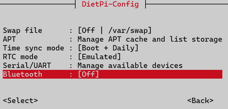

That is how it looks on my setup
Torben
Can you explain further? How did you try to disable it?
I guess this should describe the Issue · GitHub

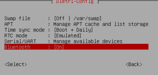

Mine looks like this:
When I hit select, or enter, nothing happens.
I’m trying to add a Home Assistant Voice to my HA setup on DietPi, but because it detects Bluetooth on the device, it gives me an error on the install. Reddit says that I need to disable Bluetooth on the pi/DietPi and that will allow the setup to go through.
I also tried:
sudo nano /DietPi/config.txt
and got this:
It’s known visual issue as stated above. And /dietpi did not exist. It has been moved to /boot/dietpi/ years ago.
